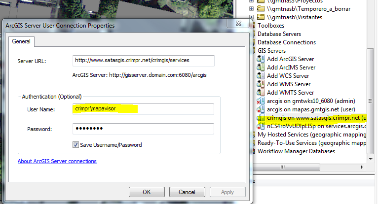

we add the server using username and password and we do not see the mapas_seguros folder.

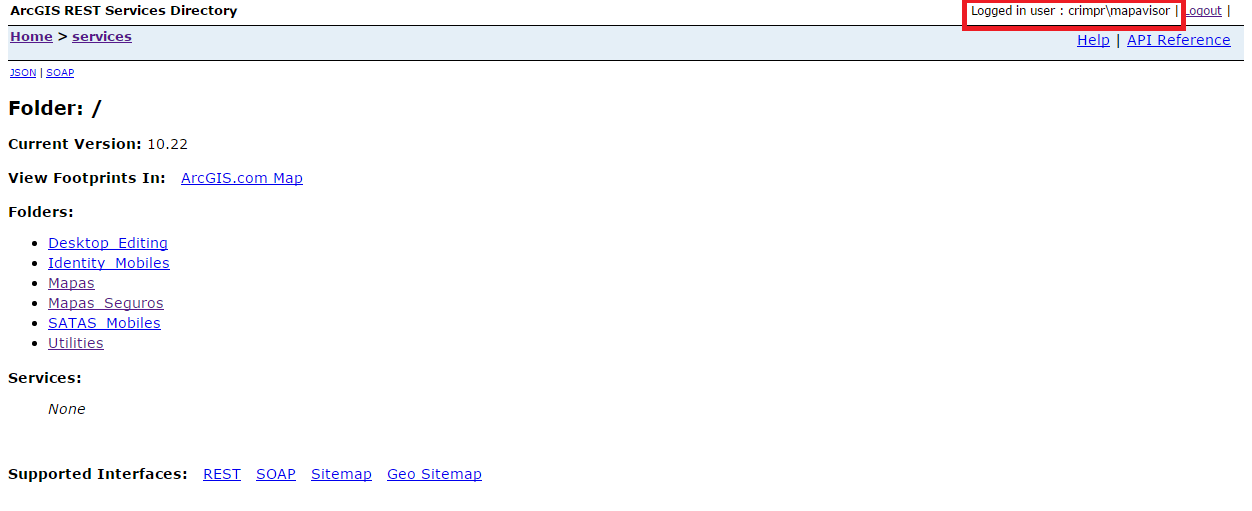

But if we login to rest services using mapavisor user we can see the folder and the services (image2).

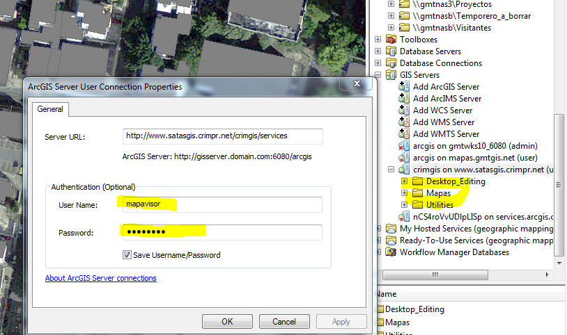

The difference is when we to login to rest services we use crimpr\mapavisor and if we use  that form on the server we do not see any folder. (image 3)
