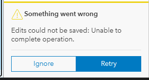

Hello,
I published a feature layer to ArcGIS Enterprise with GlobalID and attachments enabled. However, I need to first create and save a point, then go back and select the same point to add an attachment. I can't perform both actions at the same time — I get an error whenever I try to do them together.(See below)
I published the layer from ArcGIS Pro to an enterprise geodatabase by reference, using registered data. I chose the 'Map Image' option and selected 'Feature' for the federated server. I also cleaned the NULL values based on the guidance in this blog:
https://support.esri.com/en-us/knowledge-base/error-something-went-wrong-edits-could-not-be-saved-00...

Hi @anonymous55, what version of Enterprise are you using?
I would try adding the feature service to an ArcGIS Online web map and see if you can reproduce the error.  If you it works in AGOL, it may be an issue with the version of Enterprise your running.

@JakeSkinner Thanks for the advice—I was able to test the layer in AGOL, and it worked fine. Apparently, this issue exists in version 11.1 but not in 11.3.
