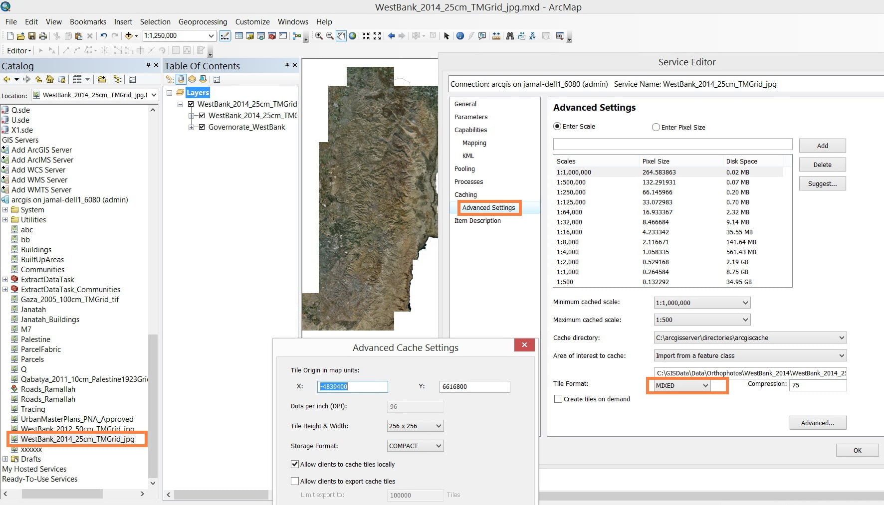

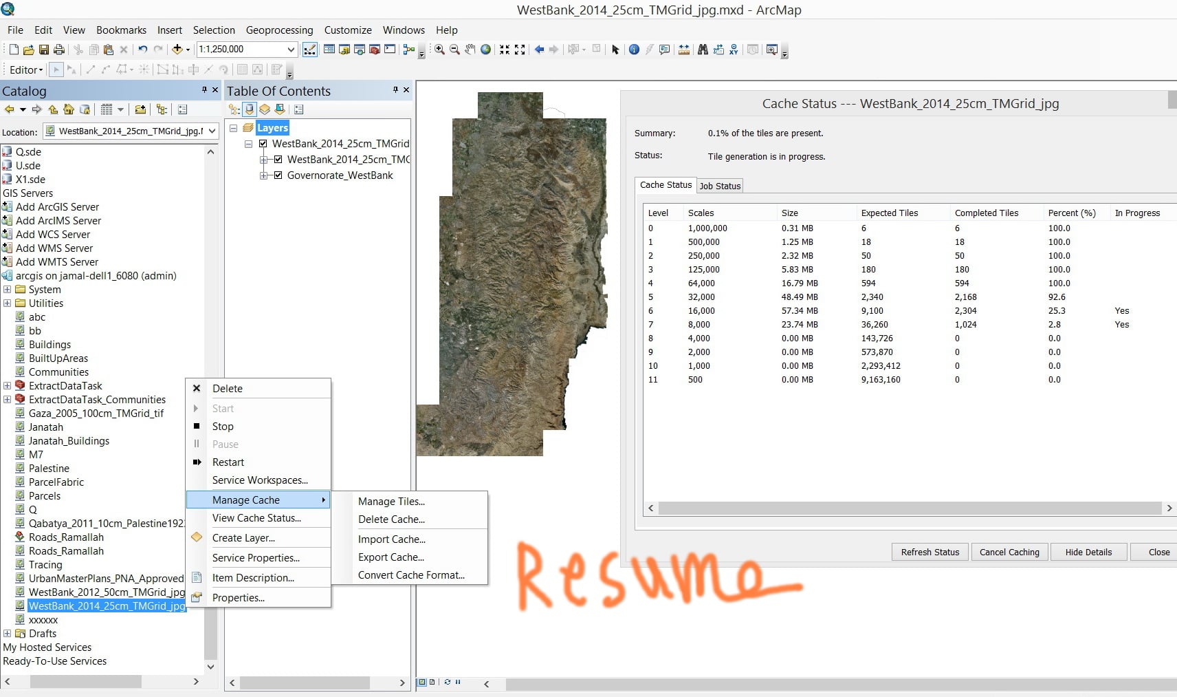

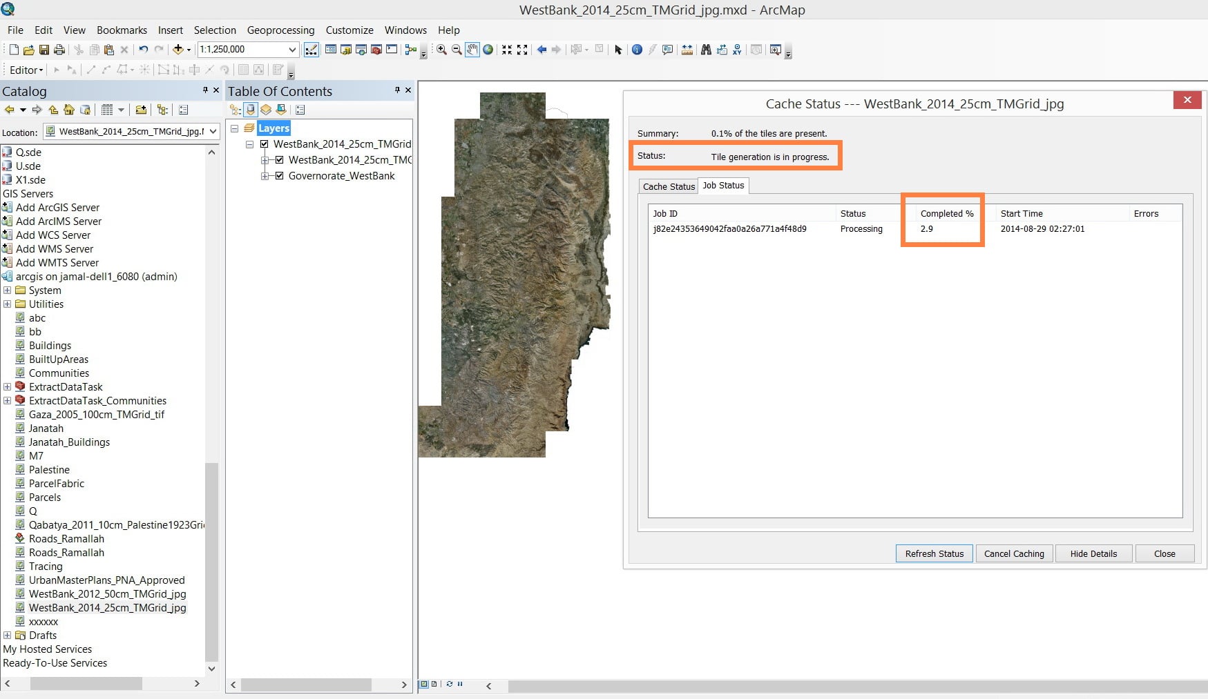

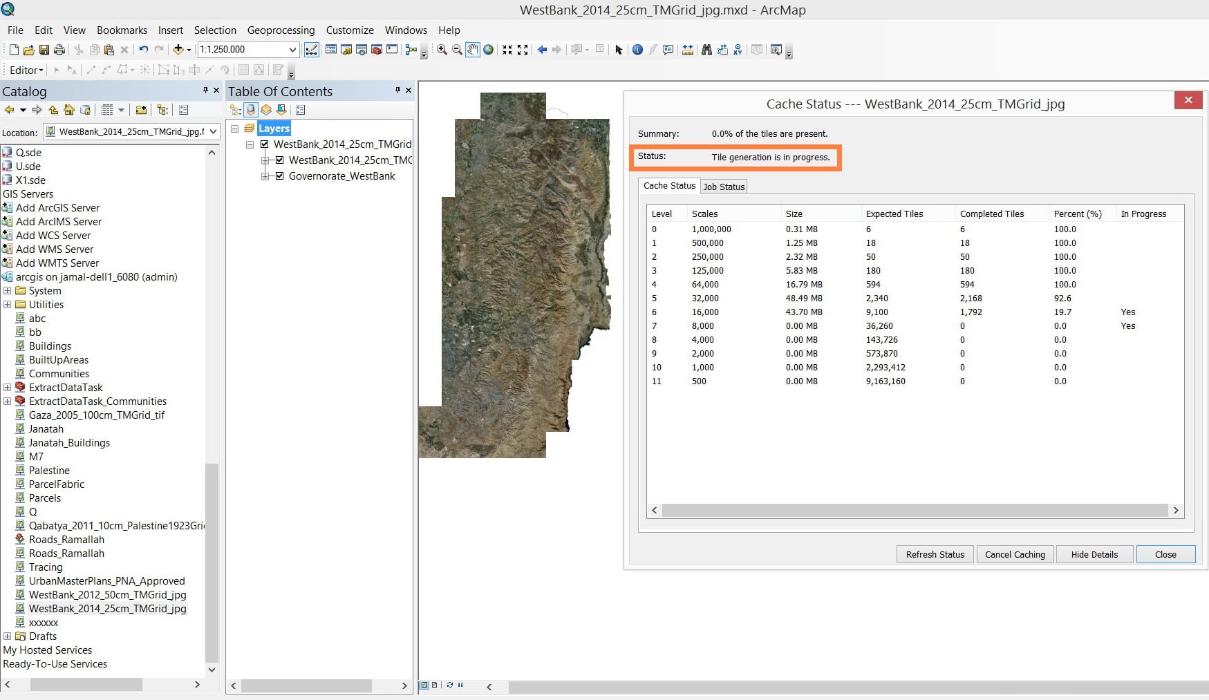

When caching is applied, publishing takes massive time to finish. I’m wondering if there is a way to resume publishing is case it is stopped due to electricity cut or even as a result of machine crash.

If the cache were to stop generating, you can right-click on the service > Manage Cache > Manage Tiles.  Change the 'Update Mode' to 'RECREATE_EMPTY_TILES'.  The cache will only be generated for the missing tiles.
