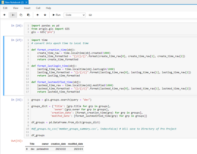

Hi,
How to export a csv list of members in a specific group in enterprise? I am able to generate some of its data: owner, Title, Date creation, date modified...  I am using Notebook in ArcGIS Pro.
thanks in advance for your help.

KikSiops
update: I am able  to generate using this tool:
PanunTools/docs/README_CreateGroupMemberListAGOL.md at main · mpanunto/PanunTools · GitHub
But I am still very keen to know how to run in from notebook.
thank you!
