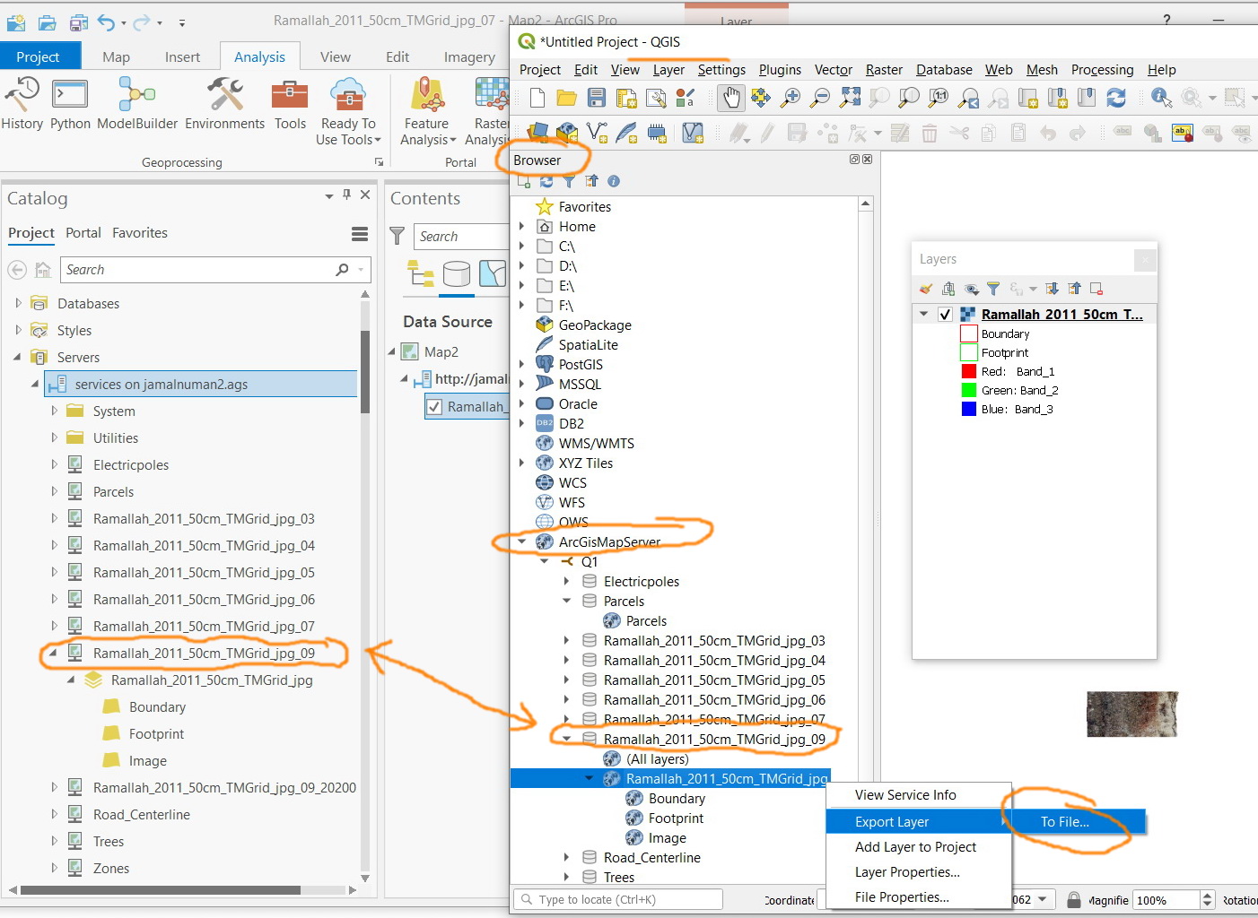

Not sure why this should be easy with QGIS, for example, as shown in the screenshot below. For me, I don’t prefer to other software to perform some actions while all our deployed system is esri based.
Jamal Numan
TanuHoque
I never tried it from QGIS.
But I'd say no - it is a not a client side issue, it is map services that don't provide any option for client to download source-data from a raster layer.
What you would get out of QGIS is most likely a picture (png) of the raster layer, not the original raster data. That is why you should use 'image service'. I'm not an image service expert, but my understand is that it would allow you to access the source raster data.
