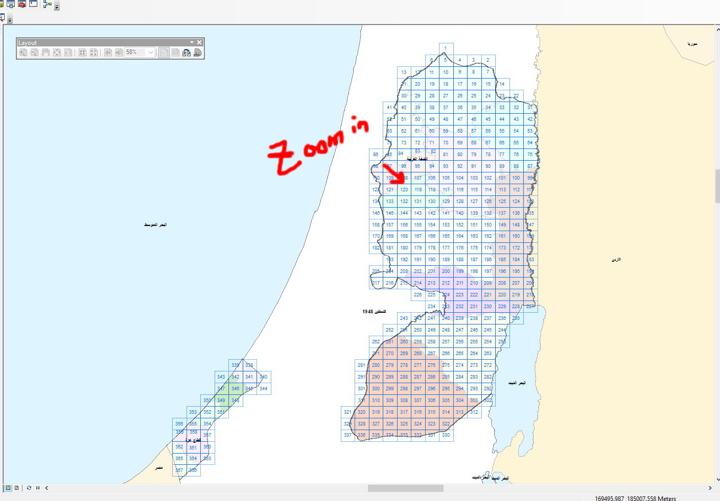

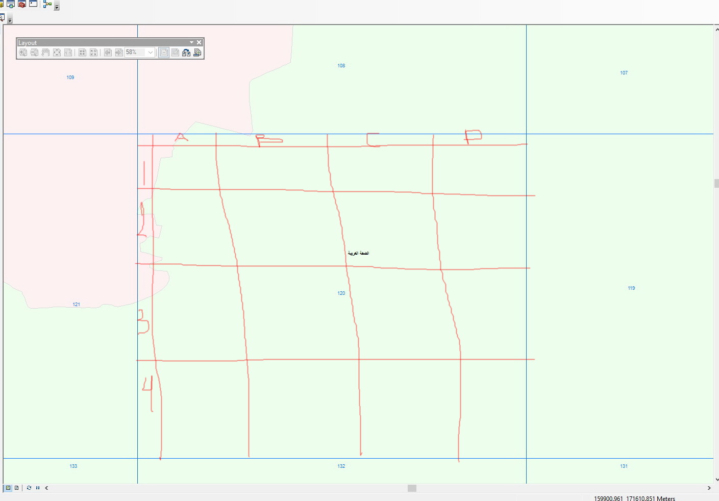

How to divide each polygon in a grid layer into a specific number of labeled columns and rows on Data view.
I have a grid layer (index) and I am trying to divide each grid into a specific number of columns and rows (A,B,C as Columns and 1,2,3 as rows) in order to intersect these new grids with a point feature layer to have the exact location of a point, ex: in page 120, zone A3).
Please, note the attached screenshots for more details.

MariamKhayyat
Kindly find the attached screenshots that show the final results after using the Custom Grid tools in our case.
