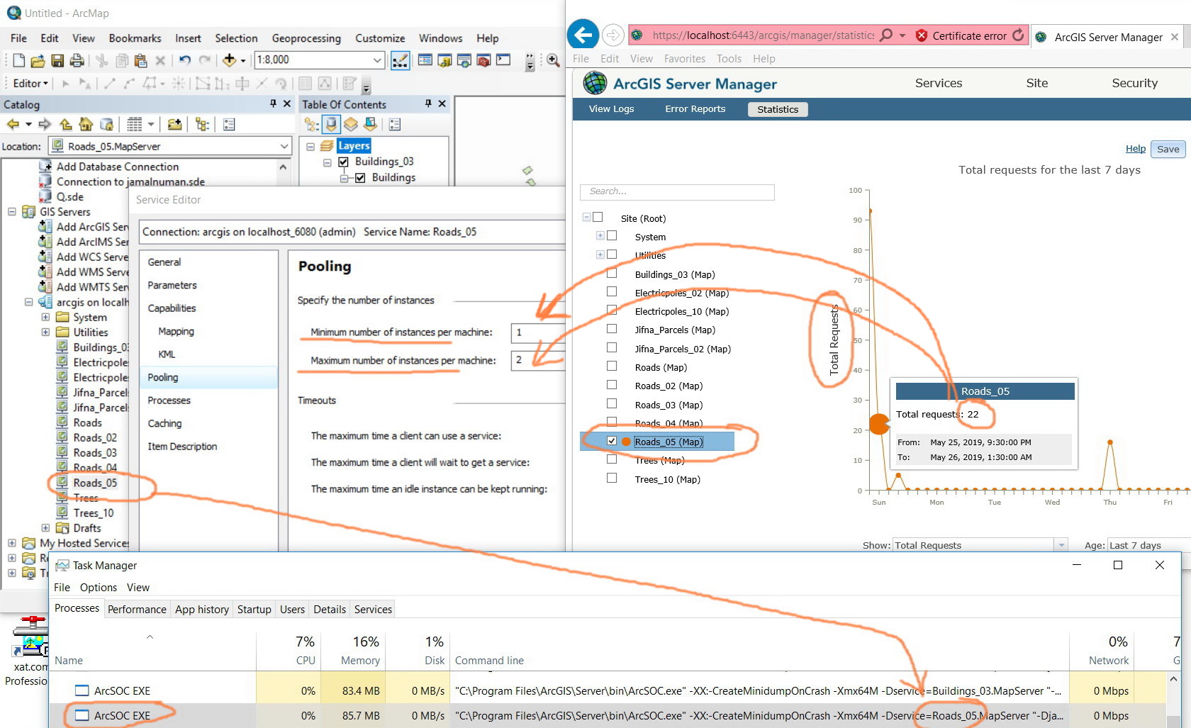

1. In the screenshot below, I have a test machine of 4 cores. Does this mean that total number of instances (ArcSoc.exe) the machine can take is 5? Or the 5 is the maximum number a single service can take?
2. What is the difference between the instance and ArcSoc.exe in this sense? Aren't they the same?
3. To calculate the optimal number of instances (ArcSoc.exe) the service needs in order to respond to the requests, the only known value (from the statistics of ArcGIS Server Manager) is the number of requests. This suggests that there should be a mathematical formula by which one calculate the optimal number of instances (ArcSoc.exe). am I correct?
- In this scenario, the maximum recommended instances per service would be 5. Some 4 core environments are able to handle a higher number of max instances per service, though some environments might require the max instances to be set at N-1 to achieve the desired performance. You'll have to play around with these settings and test to see what works best for your organization.
