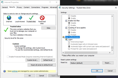

DavidHoy
Grant, sorry to ask, but to be clear
Did you also check the box in Custom Settings for "Trusted Site"/"Local Intranet" to allow "Automatic logon with current user name and password"?
As Chris P pointed out in earlier post in this discussion. This is a CLIENT SIDE setting that you may need to get pushed to all users via a Group Policy setting once you have shown it works for the machine from which you are testing.
GrantHopkins1
Hi David,
No need to aplogize, I appreciate you taking the time to help out. So yes, that setting was already checked on and is managed by my IT department.
