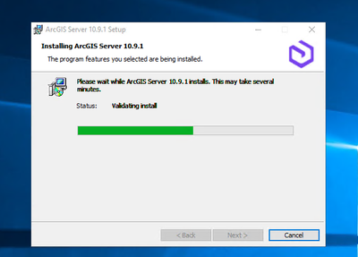

I am currently upgrading our single machine deployment of ArcGIS Enterprise from 10.8.0 to 10.9.1. I was able to get through Portal, which took about 6 hours, and the portal web adaptor. Currently I am upgrading the Server and it is still validating the install 17 hours later. This seems excessive. Anyone else have it take this long? Ideas, suggestions?
