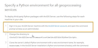

We found that there is an important step in the details here deploying-custom-python-packages 10.9 that is not in deploying-custom-python-packages 10.7   - but it made a difference for us.
What we found was that the environment was cloned from another version (it was actually a Pro environment) and we needed to clone the default ArcGIS server environment on the server and then add the custom modules we needed.
But this time, we did everything logged into the server as the ArcGIS service account - the domain-level account that we have the runs the ArcGIS server service.
We found that starting the Python 3 Command prompt from the server would show the initial environment for that profile - not the new custom one we had used proswap to activate under a different windows login that we were publishing from.
We used the correct clone of the initial environment, set the registry key to use that, then used the proswap function to change the environment. Restarted the ArcGIS server service, and the  Python 3 Command prompt showed the new environment, then publishing the GP service from our other profile worked, no Python errors.
