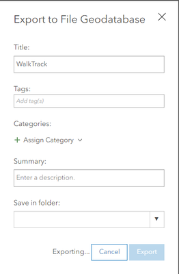

open the overview page of the hosted feature layer, go to Export Data
Select Export to FGDB
fill in the form
Then download the GDB

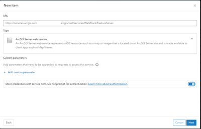

navigate to the overview page at the bottom you will find a url copy that url and navigate back to AGOL
go to content and add new item and select URL
past in your URL you will see a store my credentials with service item this is important to tick otherwise you will be prompted for a login from the ArcGIS Enterprise
provide login credentials if the password changes you will need to setup the password again in AGOL so use a service account with a very strong password to host your services.
save your service

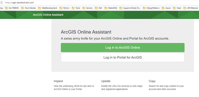

what is left to do is to reconfigure your maps to use the new service instead of the old service you do this by using ArcGIS Online Assistant (esri.com)
log into ago-assistant navigate to the maps that use the url and update the url with the new url, if the layer order has changed then make sure you change the layer order as well
select  Update the URLs of Services in a Web Map
update your Operational Layers with your new url, you will have to edit the JSON if you want to update the itemid aswell
