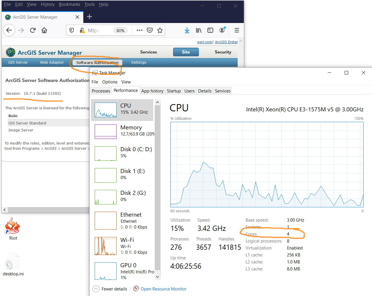

How about the performance of ArcGIS Enterprise with 4 Cores licensing that is installed on a server machine with 64 cores?
I couldn’t figure out how the number of cores licensing is affecting the performance (or whatever else) of the ArcGIS Enterprise.
For example, how the ArcGIS Enterprise with 4 Cores licensing that is installed on a server machine with 64 cores is different from the ArcGIS Enterprise with 8 Cores licensing that is installed on a same server machine (64 cores)?
