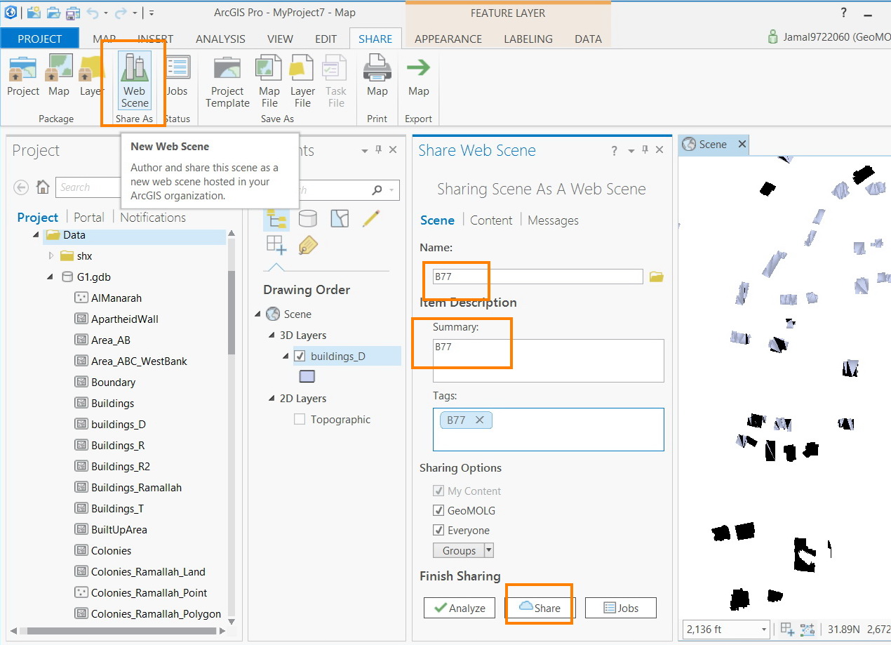

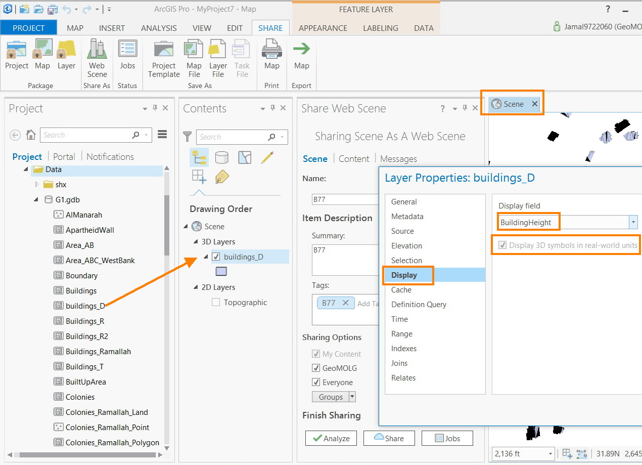

What I have done in the past is export the ArcScene document to WebScene like this:
Help can be found here: Export To 3D Web Scene—Help | ArcGIS for Desktop
For ArcGIS Pro you can find a description here: Author a web scene—ArcGIS Pro | ArcGIS for Desktop

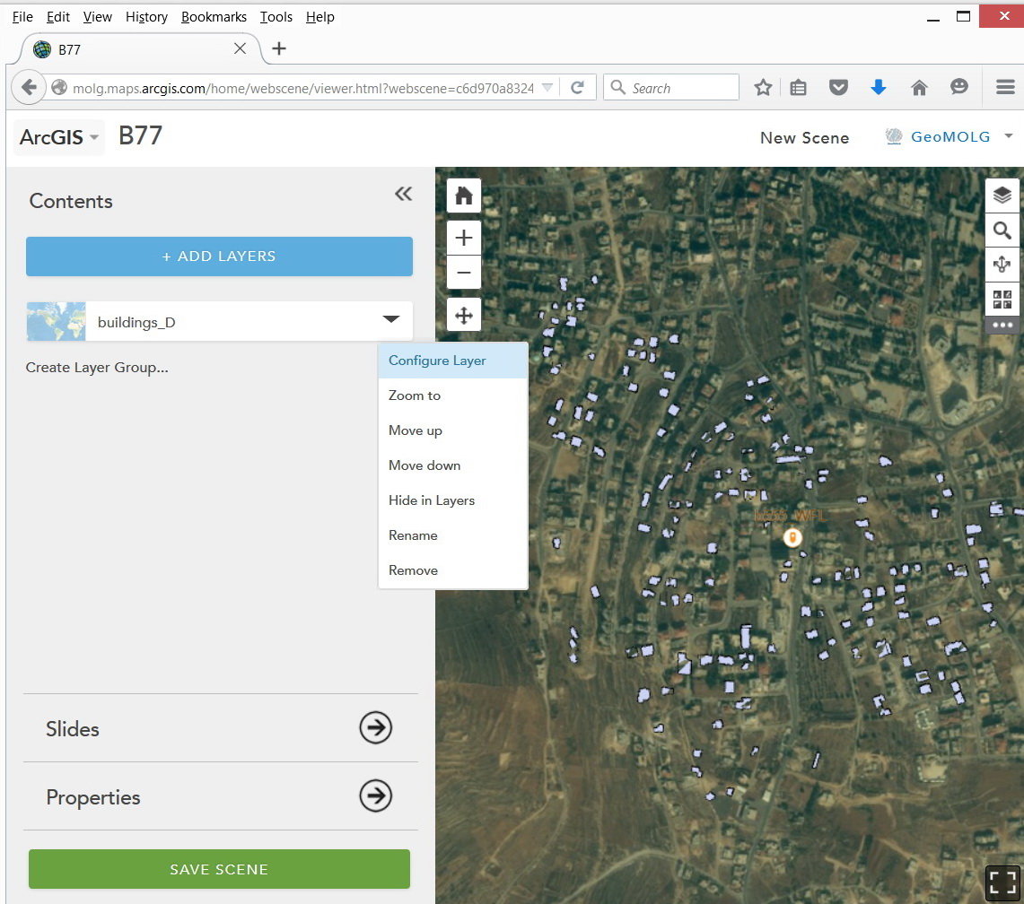

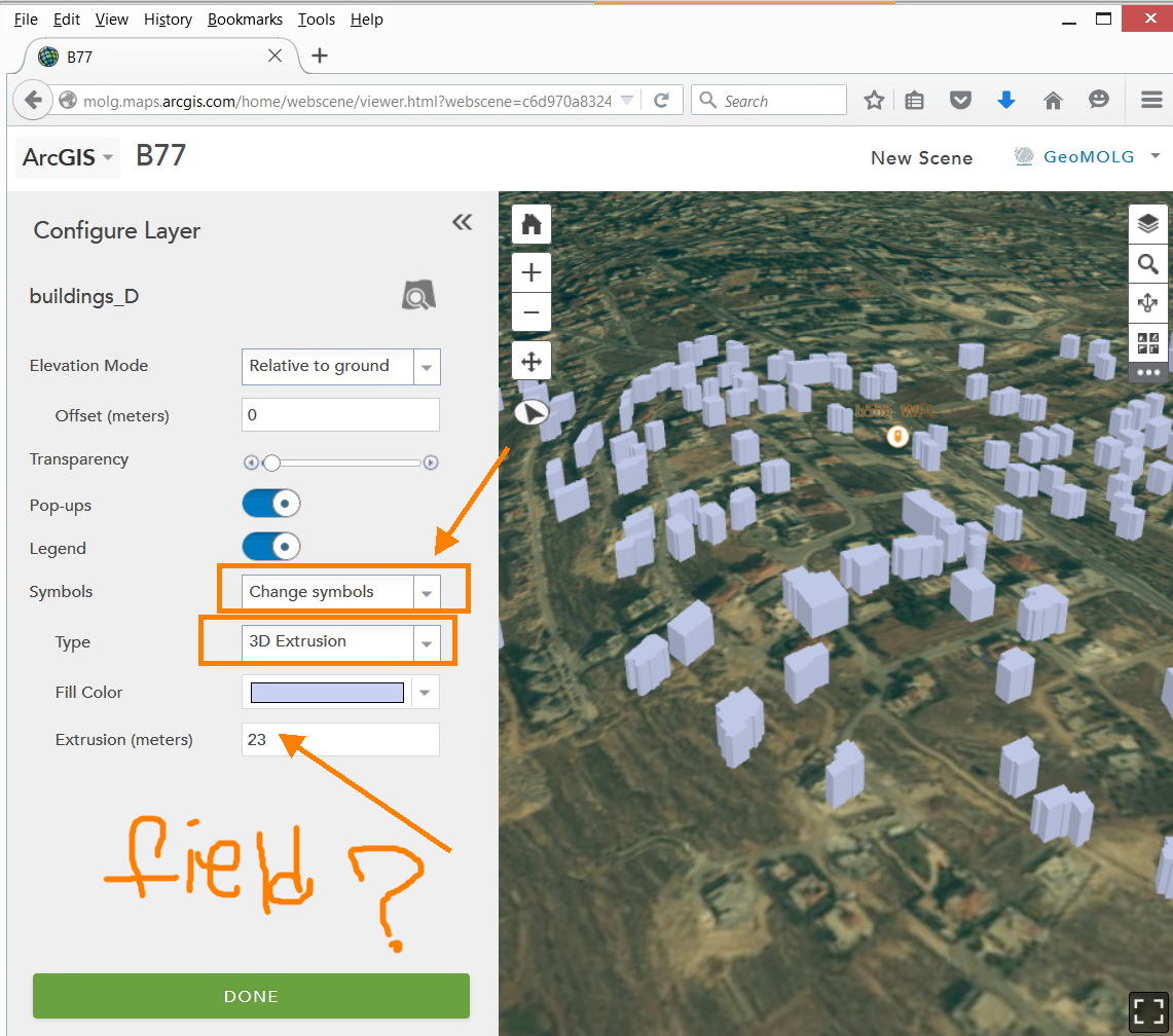

JamalNUMAN
Legendary Contributor
I got this:
