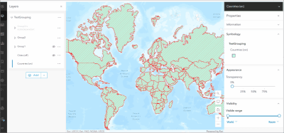

It worked for me when I tried. Pls see below. By any chance do you have symbol layer drawing enabled at your group layer level?
Thanks
map_image_layer_grouplayer_shuffle_order.gifmap_image_layer_grouplayer_shuffle_order.gif

What you showed is correct. But you cannot move the layers outside of the group. In my case, I am trying to group both an Image Layer and a Service Layer under the same group. For example: I have a Feature Layer for our sanitary sewer but I have another layer in a Map Image Layer that I would like to put in the same group as the Feature Layers. Unfortunately the layer that I'm trying to move has to be in an Map Image because it's a Database View.

Ideally I would look to move layers out of the Map Image layer. But I understand that's not supported. However when you have multiple groups setup in the table of contents, click the options button on the layer within the map image layer, there is a Move option where you can choose to move it to a group (or even no group). When you attempt to move it to a different group it doesn't work (which makes sense bc that action is not supported). BUT when you choose to move to No Group it will make a copy of the layer in the table of Contents. It wont work but it will show the layer there none the less.
I guess including that as an option in the map image layer is miss leading knowing it not a supported action.
And you're also right about the other issue you brought up. In short, Map Image Layers do not get along with groups in general, regardless if they are within the map image layer or outside.
In the example snippits I've included, I'm attempting to move the the Image Layer 'Pipelines' into a custom group I created. It will not move it to the group, but when I choose 'No Group' it will make a copy all by itself, but it kills the map.
