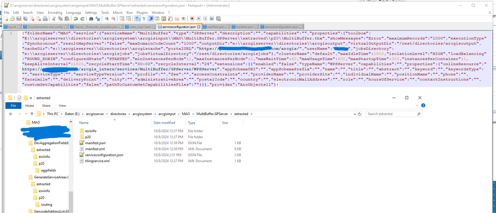

i have an arcgis server with its content directories configured on the c drive. (c:\arcgisserver\directories)

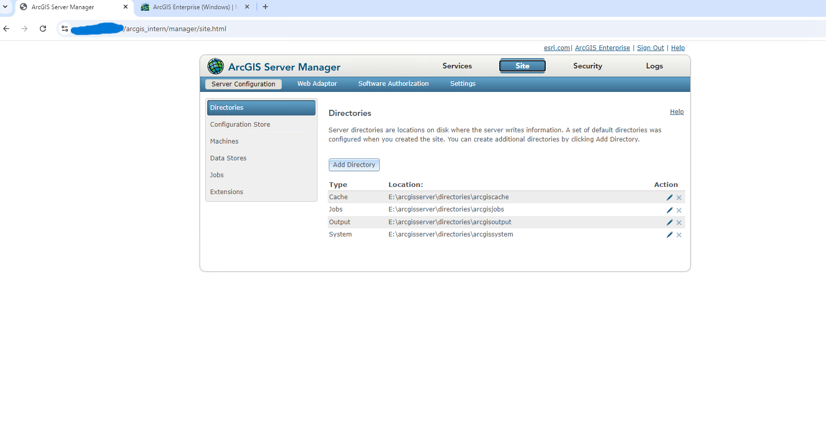

Today I moved the directories to another disk with more space. (e:\arcgisserver\directories)
I did this in the server manager, Site -> Directories.
All of my mapservice are working fine. But all my geoprocess fail.

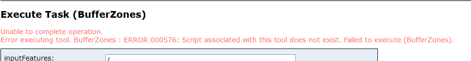

Every one of this geoprocesses throws the error "Script associated with this tool does not exist. Failed to execute"

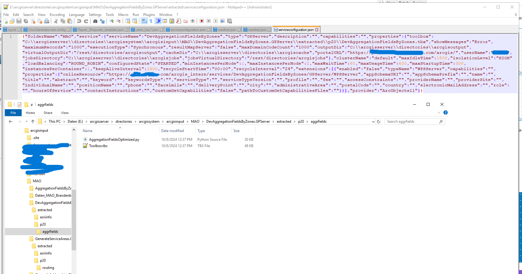

I looked into the new directories, all the necessary files are moved.

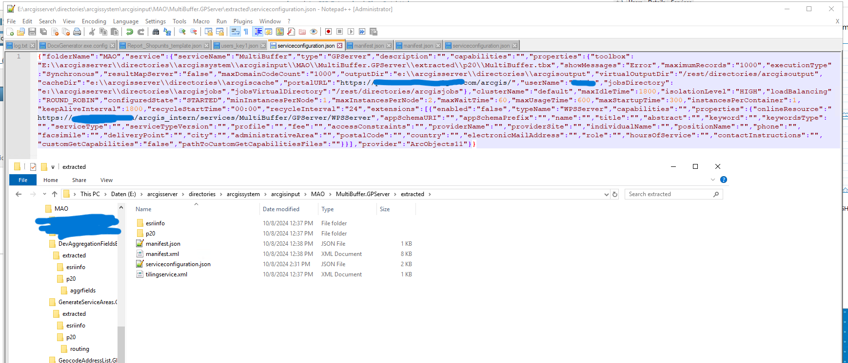

Looking into the "serviceconfiguration.json" pathes still have "c:", should the server had updated the configs?
In one of the services I manually updated the config to "e:" and restarted the service, but still got the same error.
The server log also doesn't log more then the error mentioned, even on Debug.
