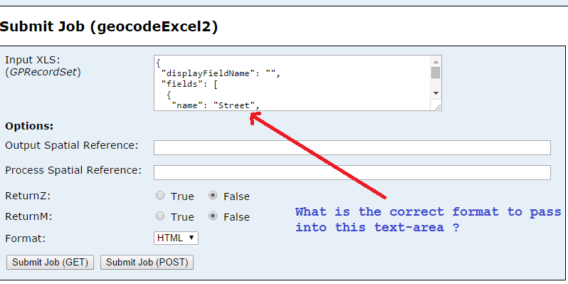

We published a GP 10.1 service to take address in csv format and geocodes it for display on a map. But we couldn't get it to work. We always get error back when submiting it - "esriJobFailed". I think it could be that we passing in a wrong input format.Does anyone have a sample on this input parameter format?
Thanks, -atip

Thanks All,  we already found the answer. A co-worker here shows me the correct input format. This is how the input string looks:
"displayFieldName": "",
"fields": [
   "name": "Street",
   "type": "esriFieldTypeString",
   "alias": "Street",
   "length": 255
   "name": "City",
   "alias": "City",
   "length": 255
   "name": "State",
   "alias": "State",
   "length": 255
   "name": "Zip",
   "type": "esriFieldTypeDouble",
   "alias": "Zip"
   "name": "Attribute1",
   "alias": "Attribute1",
   "length": 255
   "name": "Attribute2",
   "alias": "Attribute2",
   "length": 255
   "name": "Attribute3",
   "alias": "Attribute3",
   "length": 255
   "name": "ObjectId",
   "type": "esriFieldTypeOID",
   "alias": "ObjectId"
"features": [{
            "attributes": {
                "Street": "114 Lathrop Ave",
     "City": "Forest Park",
     "State": "IL",
     "Zip": 60130,
     "Attribute1": "test1",
     "Attribute2": "test2",
     "Attribute3": "test3"
            "attributes": {
                "Street": "118 Lathrop Ave",
     "State": "IL",
     "Zip": 60130,
"exceededTransferLimit": false
Again, thanks all

You say it is taking CSV format and geocoding, so I would think you need:
123 sesame st, albquuerque, nm, 87102
246 beat street, new york, ny, 1234
or whatever format your geocoder requires.

Thank you, Paul. But I did try that similar format but still no luck - not working. I ain't even sure if this service is good for CSV,  because in the description it says "Excel spreadsheet to geocode" - see image.
Has anyone successfully tried this type of service on CSV format?  I looked at the ESRI Input XLS example on the service "Submit Job" page - see below.
But I don't know how to construct my addresses input in that format. Has anyone done this?
Thanks in advance, -atip
