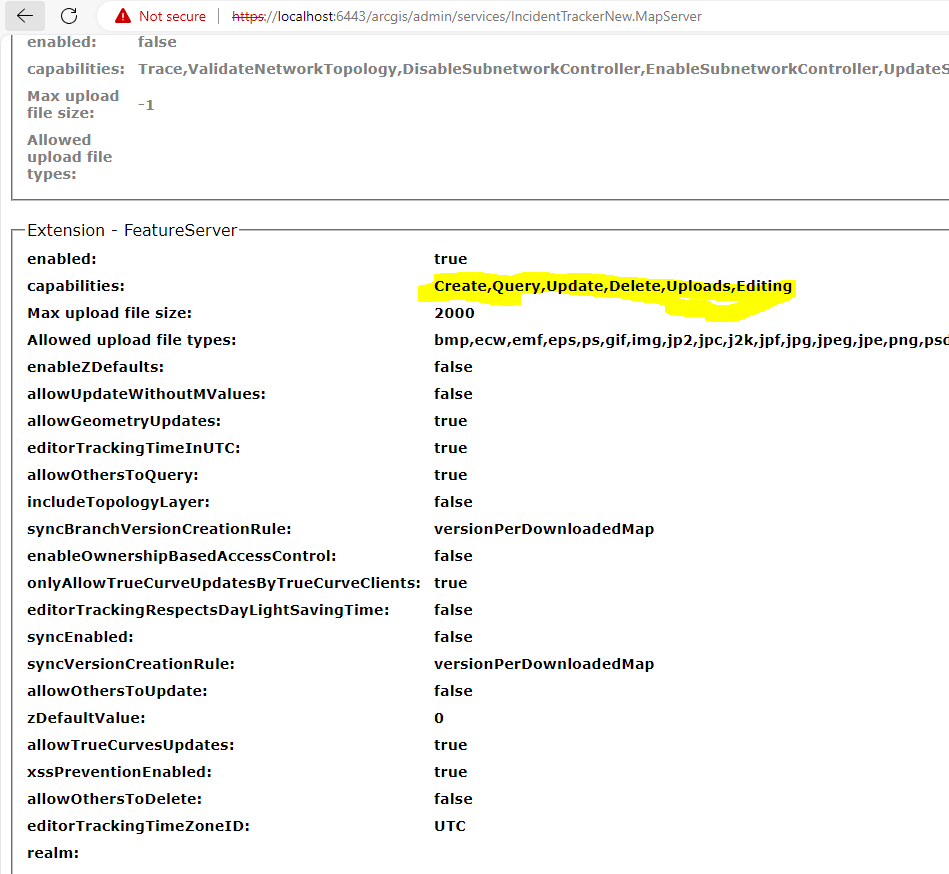

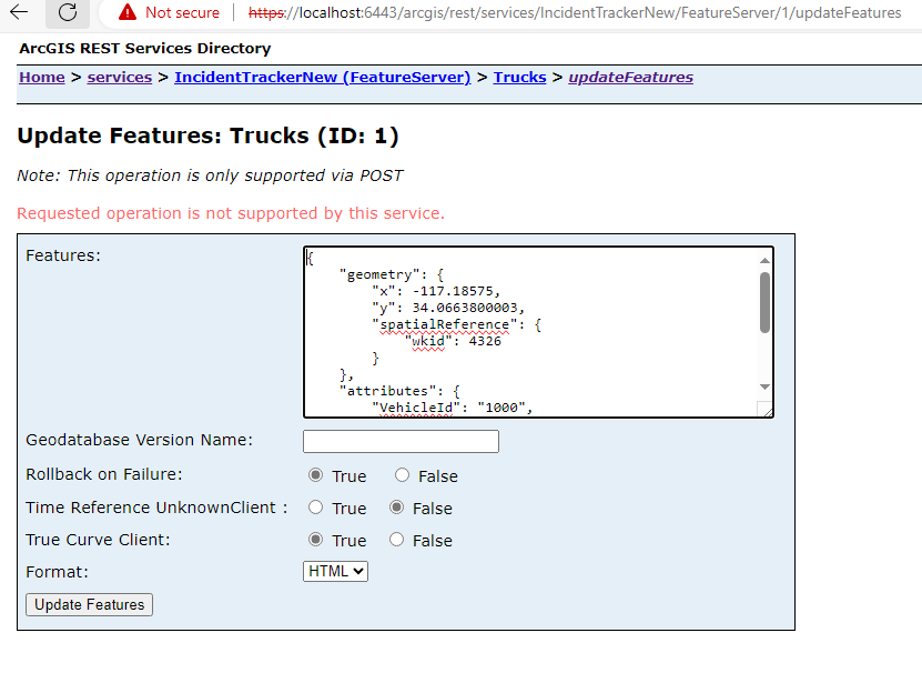

I am attempting to modify the feature service within the map service, but I encounter an error stating "Requested operation is not supported by the service." I've already granted Feature access privileges, including create, update, and query permissions. Can someone provide insights into possible reasons for this issue?
Below are some screenshots of the permission settings and post requests.

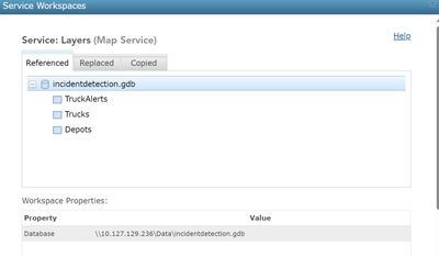

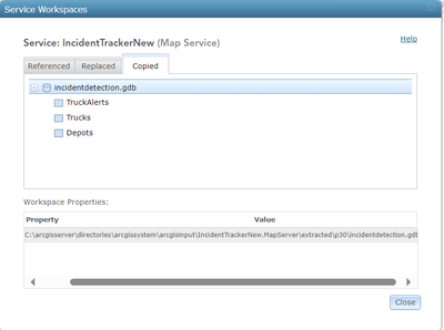

@Oiligriv , Thanks for your response . Here the service is using the geodatabase file and we haven't configured to any external database. Below is the snapshot of the Database information . Additionally we have configured the ArcGIS Datatstore for Relational and Tiles. Could you please help in identifying the issue by these information.

you have performed a publication by uploading the Geodatabase file within the service.
to use insert, update, etc etc you must republish the service and write the data into ArcGIS Datastore.
