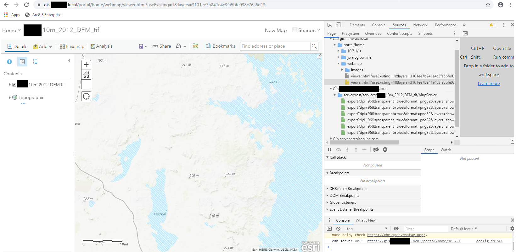

It federates ok, and items seem to populate in new Portal, but Map Image Layers do not load in Map Viewer. I get item name appear loaded on the Content pane, and the map zooms to the extent. But it is empty or transparent.
In the browser F12 console it looks like authentications and tokens are going through, and there is response - I see a lot of :
https://<10.5 arcgis server>.<domain>.local/server/rest/services/XXX_10m_2012_DEM_tif/MapServer/export?dpi=96&transparent=true&…
everytime I zoom around the map, which makes me think it is accessing something from the Map Service.

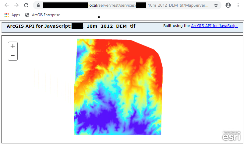

 - I can load the Map Image Layer ok independently in the JS Viewer
