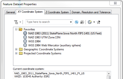

1) Dataset Working103 = dataset created with ArcGIS 10.3.  SRID = 103045 (NAD 83 Iowa State Plane North 2011)

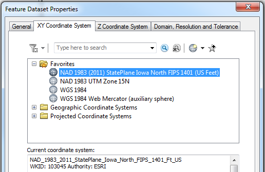

2) Dataset Working1031 = dataset created with ArcGIS 10.3.1.  SRID = 103045 (NAD 83 Iowa State Plane North 2011)

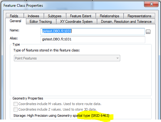

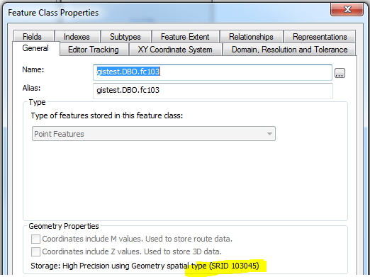

Next, I created a simple point feature class within each dataset, and inserted 3 features within each feature class.  The feature class within the dataset created with 10.3 has the same SRID as the dataset, 103045.  The feature class within the dataset created with 10.3.1 has a SRID of 6463, which I can't seem to find browsing through Esri's list of coordinate systems, so I have no idea what it is.
Feature class within dataset created with 10.3 has the correct SRID
Feature class within dataset created with 10.3.1 doesn't have the same SRID as the dataset

It's due to the fact that the CRS had an Esri number at 10.3.0, 103045, but was "code changed" at 10.3.1 to update the well-known ID to the EPSG one, 6463. They're just different numbers pointing at the same definition. Using the older number in a query that passes through the Esri projection engine, the older number is converted to the new one before use.
