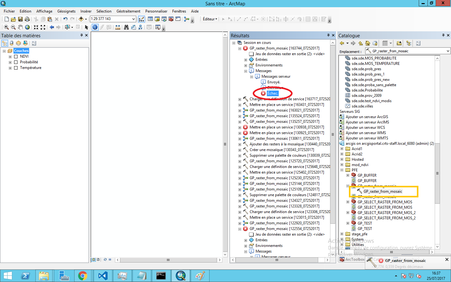

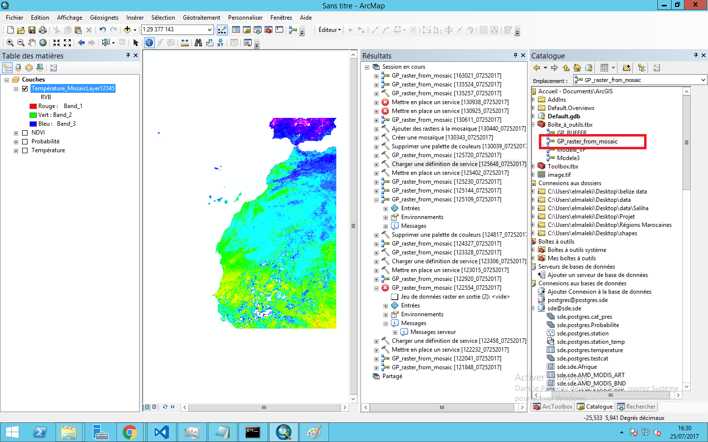

I am trying to publish a working model created using Model Builder which returns a significant result when executed on ArcMap. After having published the model on the ArcGIS Server, it doesn't work, here are some snapshots :
Model Builder
Execution on ArcMap and visualization (red rectangle)
After publishing the geoprocessing (executed from "orange box")
We get a error message (red circle)
We need help please.

So Google Translate tells me that the error is "Invalid return value".  Is that correct?  If so, can you check the directory manually using ArcMap or ArcCatalog and verify that the data it's expecting is in the scratch geodatabase?  Basically, follow the path in the error to see if the data is there, which is outlined here.

You're right, the error is invalid return value.
I explored scratch.gdb, I found that it doesn't contain any result of the geopocessing.
