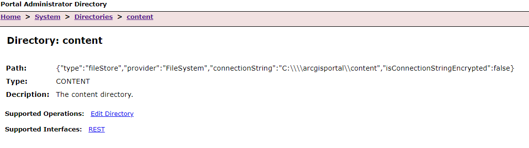

Double check the content path within Portaladmin. Is it set to C:\\arcgisportal\\content, or C:\\\arcgisportal\content? It should only have two slashes in between each folder level.
JaredYost3
JonathanQuinn
Esri Notable Contributor
Edit the content directory to remove the doubled up slashes in the connection string. It should just be C:\\arcgisportal\\content and try again.
JaredYost3
That fixed my issue perfectly.  Thank you.
