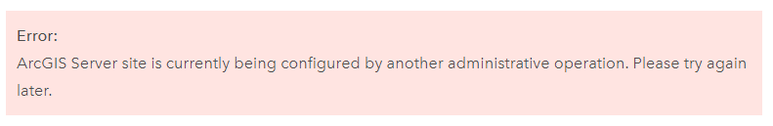

The folder migration procedure perpetually goes into error with the following message:
But there are no operations in progress.
After several attempts, I somehow managed to get 3 out of 4 folders migrated, but after migration it always failed.

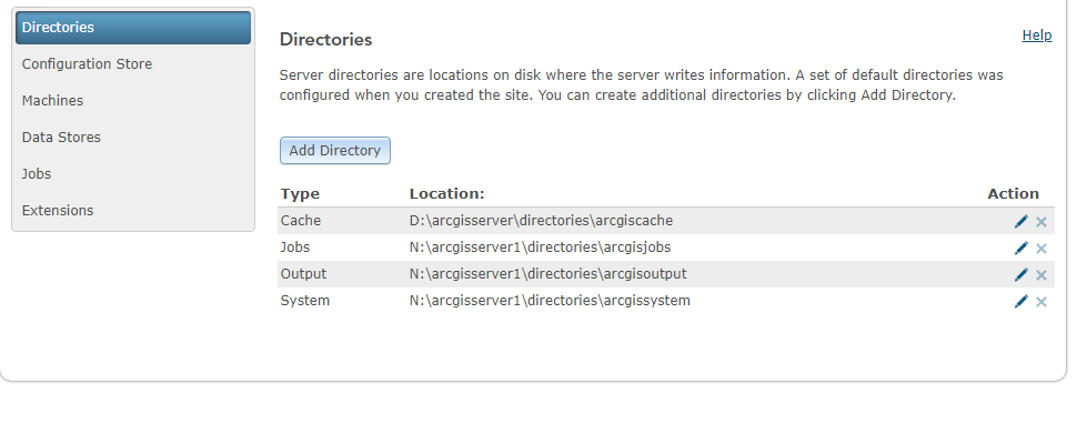

Hi.  I see you're using N drive.  Can I ask if that is a mapped drive to a folder share elsewhere (I'm assuming it is).
Mapped drives (like N) are created for your profile.  As an admin on the machine you can see the N: and create connections to it etc.  However, ArcGIS Server is 'not you' and runs under its own profile, there are one of two options:
1)  it runs as a local account, which cannot see remote folder shares,
2)  or it runs as an AD account.  So two things, on that.
  •  Does the AD account know what an N drive is?  Login to the machine as the service account (you'll need to set permissions to do that).  You may need to map the N drive for that system account.
  • Also does the folder share have read/write permissions for the AD account???
If the arcgis server account read/write from the folder then you should be good.  My best guess at this point is that the profile under which ArcGIS Server is running, has no idea where N drive is, or it doesn't have the permissions to use it?

Corrected the N disk is the mapped network disk, I also tried with the entire network path.
I hypothesized the same kind of problem and I connected with the user that manages the ArcGIS Server service, I tried to delete, create, modify folders and files, but in RDP I don't have any problem, through Server Manager I don't succeed in any way.
The machine is in google cloud with windows server 2016 and NFS network disk.

That error message is usually due to an *.rlock or *.wlock imposed on the config-store and those files can become orphaned in certain scenarios. Through a support case an analyst should be able to work with you through safely removing the lock files after confirming the account permissions are correct on the share.

The cause should as @ChristopherPawlyszyn outlined. When encountering this, one approach I normally adopt is to restart the ArcGIS for Server service process to reset the status of the ArcGIS Server. Most of the time worked for me.
RiccardoPlaia
I try many times to restart the service/machine, but without success.
To config-store folder now I have this error:
Configuration store error.
File system '\\XXX.XXX.XXX.XXX\folder\arcgisserver2\config-store\machines\VMGIS-SERVER.json' put failed.
Another administrative operation is currently accessing the store. Please try again later.
