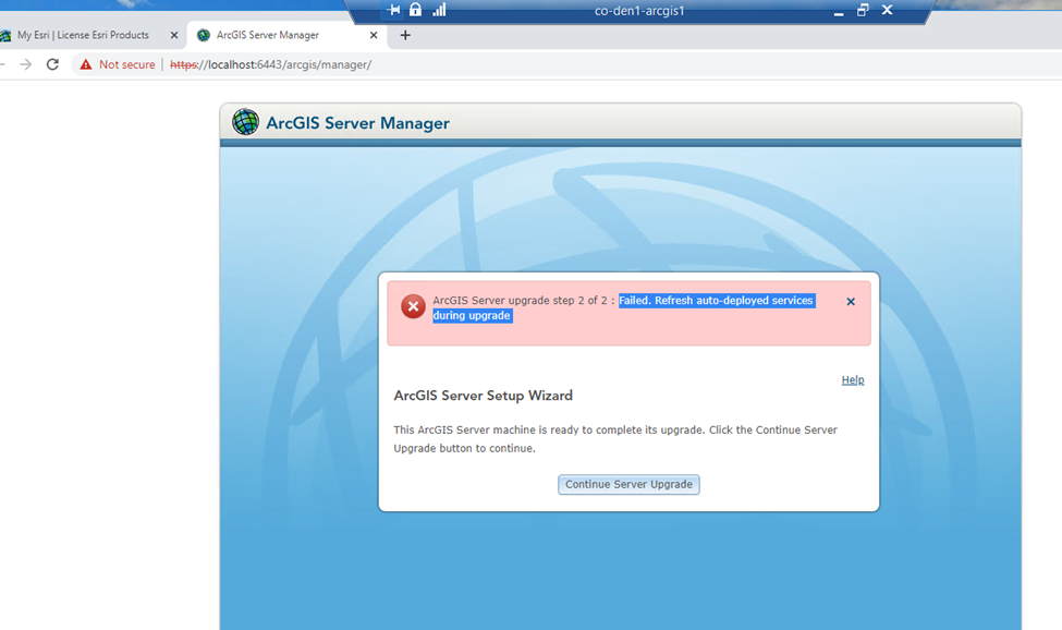

I'm getting the same error when upgrading from 10.9.1 to 11.
I'm using Enterprise Builder. The Enterprise Builder updating components completed successfully.   Then when I run the ArcGIS Enterprise Configuration Wizard part in a browser, it get's past the Upgrade Portal section and then fails on the Upgrade GIS Server site section with the message: ArcGIS Server upgrade step 2 of 2 : Failed. Refresh auto-deployed services during upgrade
I'm seeing errors in Windows Event Viewer referencing gdal_e.dll. I replaced the C:\Program Files\ArcGIS\Server\framework\runtime\ArcGIS\bin\gdal_e.dll that was version 3.4.0.34 with the one from ArcPro which was version 3.3.0.25. I rebooted and then tried to run the ArcGIS Enterprise Configuration Wizard again from a browser and I get the same results.
So I'm still stuck and replacing the gdal_e.dll didn't work for me. I have an open ticket with Esri Support: #03135661
