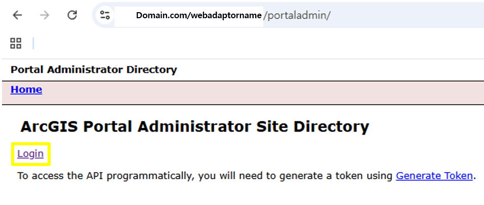

Error occurs when logging in to the Portal Administrator using the Web Adaptor URL.
393
09-28-2025 07:45 PM
Jin-taeKim
Environment: Windows OS / ArcGIS Enterprise 11.4
1. The domains for the Portal and the WAS(IIS) are the same.
2. Accessing Portal Home via the Web Adaptor URL works normally.
3. Accessing Portal Admin and Portal Home via port 7443 works normally.

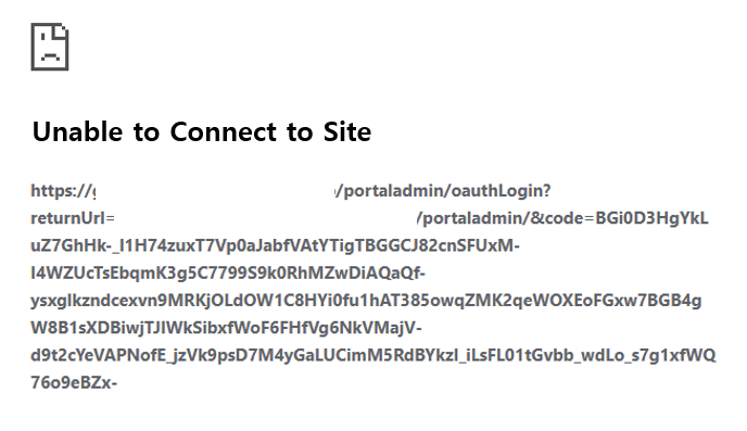

4. When accessing the error URL, an “Invalid redirect uri” error appears, so the Web Context URL was removed.
5. After removing it, accessing the URL brings up Portal Admin, but the same error still occurs
I found a similar bug, but it wasn’t particularly meaningful.
https://support.esri.com/en-us/bug/modifying-the-webcontexturl-causes-the-update-portal-ur-bug-00017...
Does anyone know why this happens, or has run into something similar?
