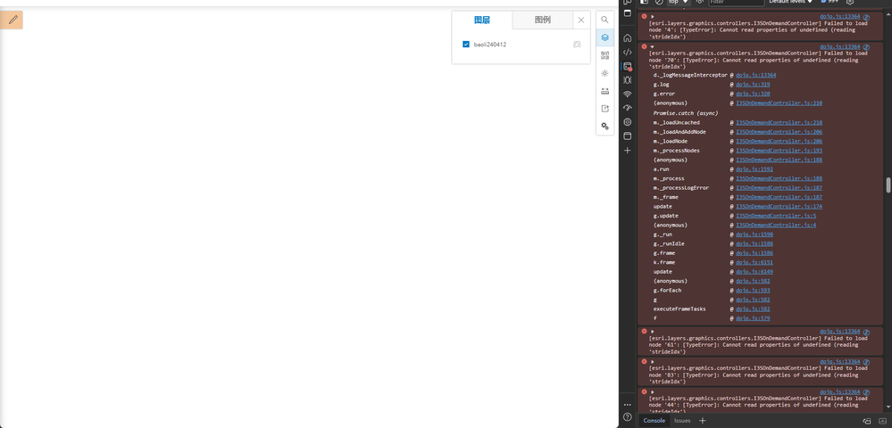

We encountered the following problem. After we released the scene service (slpk), it could not be loaded in the web scene browser, but it could be loaded normally on the desktop. Two-dimensional map slicing did not have this problem.
ArcGIS Enterprise version: 10.8.1
Server operating system: Red Hat Enterprise 9.2
Tomcat version: 9.0.19
OpenJDK version: 11.0.0.1
SSL Certificate: Configured and Unified
Check the server manager error log as follows:
<Msg time="2024-04-13T01:54:47,591" type="WARNING" code="9016" source="Rest" process="4223" thread="1" methodName="" machine="server.**unspecified**.com" user="" elapsed="" requestID="9fef31f7-8d07-42d8-92aa-f97935cc716f">Error getting service.</Msg>
<Msg time="2024-04-13T01:54:47,591" type="WARNING" code="9003" source="Rest" process="4223" thread="1" methodName="" machine="server.**unspecified**.com" user="" elapsed="" requestID="9fef31f7-8d07-42d8-92aa-f97935cc716f">Unable to process request. Service Hosted/baoli_v1_9/SceneServer not found </Msg>
Can anyone please help me? Thanks!
