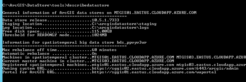

Even though, they seem to be up and running:
- Executing the command "describedatastore":

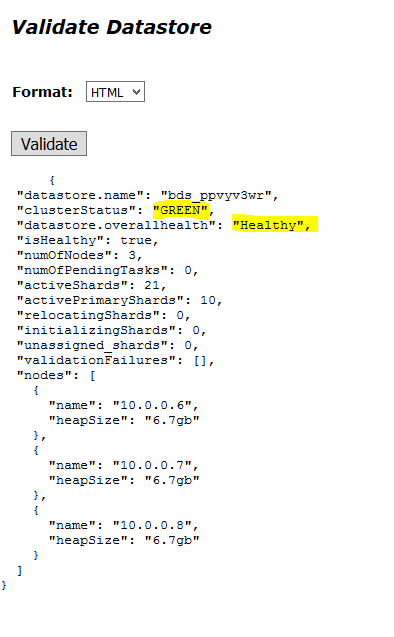

- Validating every datastore from arcgis server admin:

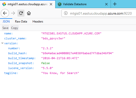

- Browsing through 9220 to every datastore machine:
