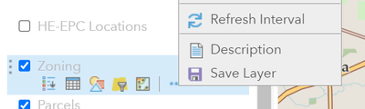

In your web map itself, you can hover over the layer to get the three-dot, then hit Description:
That will take you to the data source. If it's a rest endpoint, it will be something like htpps://domainname/webadaptorname/rest/services... if it's a federated server using a web adaptor. You might also see someting like ...:6443/arcgis/rest/service..., which means it was added not using the web adaptor, which (depending on your user configuration) could cause some login issues.
