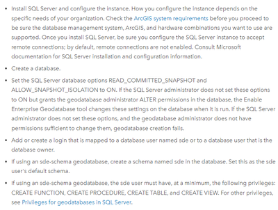

What user is the connection file using (SDE / DBO / etc.)?
Did you follow this process; https://pro.arcgis.com/en/pro-app/latest/help/data/geodatabases/manage-sql-server/setup-geodatabase-...
--- George T.
SebastianBosbach
Hi George,
the User im using is the owner of the db.
I created the sde schema and set it as the default schema for this user.
The following points I did a screenshot of are all done.

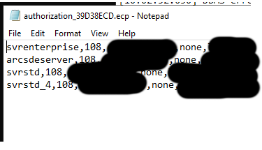

Just ruling something out.  I once responded to a similar question on these forums and it transpired that the person had a workgroup license for the geodatabase, but was trying to create an Enterprise geodatabase.  Just to be sure can you open the ecp file in a text editor and confirm you have a current 'enterprise' GDB license in there please?
Scott Tansley
https://www.linkedin.com/in/scotttansley/
SebastianBosbach
Hi Scott,
thanks for your Input, I checked the licence and from what I can see, the licence should be fine.

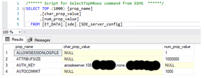

SebastianBosbach
I look into the created database and saw that it should be created correctly.
If I try to connect to it through ArcGIS pro the first time, I get an file dialog, to pick a new "valid" licence.
I input my licence but then get the same error (table GDB_Release not found).
If I look into the sql db I see that the database version is 10.9.
How ever, my arcgis server licence is 10.8. But I also tried creating the enterprise gdb with a 10.9 licence, which also doesn't work.
I don't now if these two have to match or not...
What I also can see in the sql db, is that the licence i provided should be correctly set in the db.
