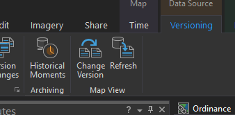

Your service should be archiving these automatically. Generally, you either need to go into the Historical Moments tab to view those historic edits, or else you need to query the database directly.
The built-in tool is easier to use, but sometimes it's nice to combine a time-based query with other filters to get really specific outputs, rather than just "the whole database as of this date".

Thanks for the reply. Using the historical tool or Add Archive doesn't seem to show the history for a branch (I may be missing something) - to show what I mean
Will editing the FS in Pro I see this as I move through my edit session
As soon as I click "Save" in Pro the edits in the table are trimmed to the last record.
and all the other edits are discarded - as I understand it it only keeps the history for features in SDE.Default.
We are working almost exclusively in versions via the Javascript API - and want to be able to see how a feature changes within a branch version - but this doesn't seem to be how it works?
