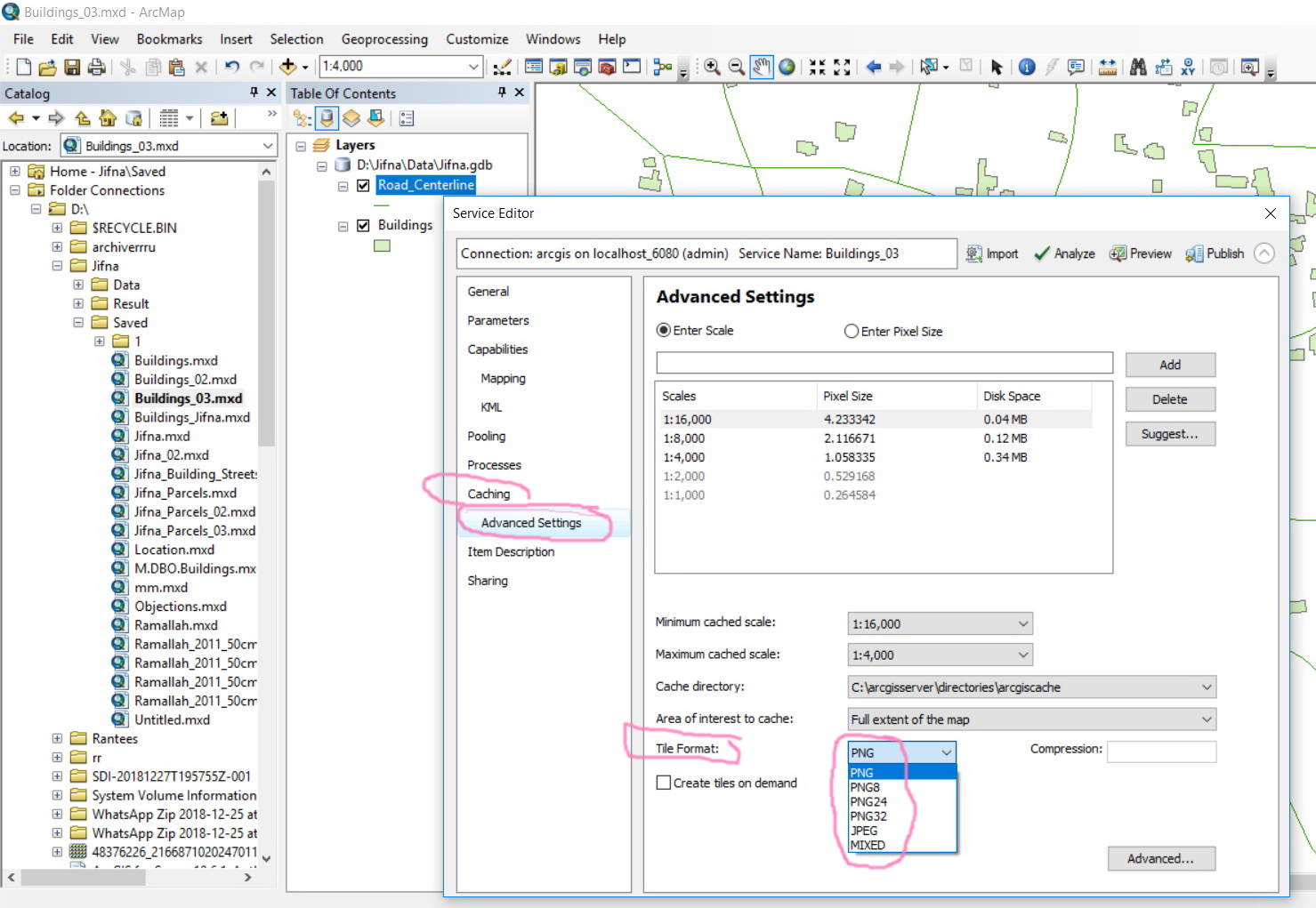

Does the type of “tile format” of a cached service affect the performance?
I’m wondering if the type of “tile format” of a cached service affect its performance when consumed.
Thank you

Aled_Jones
Hi again Jamal,
PNG format supports transparency and is a lossless format. I would assume JPEGs are prefered for higher perfomance due to the compressed file size and non transparency.
This really depends on the differences between png and jpeg handling by arcgis server from the bundle file (.bundle), which I am unfamiliar with.
Cache perfomance can be improved by tuning the disk sector size.
Hope this helps,
Al

JamalNUMAN
Legendary Contributor
I’m back to the same enquiry.
What is the best “image format” for imagery caching that brings optimum cache tiles in terms of quality (high degree of color variation) and performance
