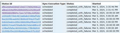

I am seeing frequent failures with the collaboration syncing one or more layers.  The Collaboration Sync Status area of /portal/sharing/rest currently looks like this:
Digging in to one of the "completed_with_failures" records, I see messages like this:

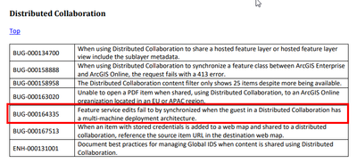

There is a bug in Enterprise 11.1 for multi-machine deployments that is fixed in 11.3:
113-IssuesAddressedList_06112024.pdf (esri.com)
In addition to edit sync failures, I was getting a lot of those generic "failed to export item" errors while still on Enterprise 11.1. Upgrading to 11.3 resolved my issue.

Thanks for sending, I hadn't seen that.  That doesn't apply to me specifically because I'm running a single-machine deployment, but it gives me hope at least that the issue will resolve itself after we upgrade to 11.3.  I'm looking to perform that upgrade this fall.
