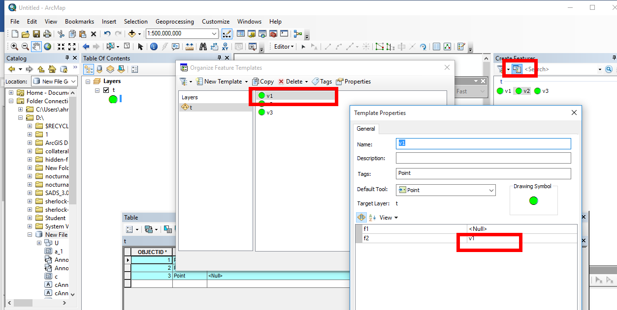

Dear Jamal,
Have you tried feature templates (F.T)? if the field f2 has a number of known values lets say (v1,v2,v3) you can create 3 feature templates an each time you can assign deferent value for f2. When the user start editing your F.C he will have 3 F.T and he should select one of them to digitize the point the values of f2 will be entered directly based on what was defined in the feature template.

I wanted to fix this issue at the level of Desktop so that it can be inherited when the layer is published and consumed in a web mapping application. With the solution you have already proposed, I think this might not work
