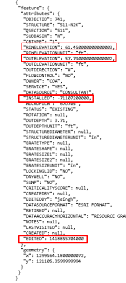

When someone performs a query in my application - they get the wrong date showing in the popup; however the correct date is in the .mxd that has the service. When I did a query on the map service - I notice that both my date fields look a bit odd (and there are few other ones too highlighted in red) because its missing the double quotes when you look at the JSON result.
I checked multiple places to see if I had the layer ID's right and made sure everything is pointed to the correct service and they are, so I'm not sure if this is where I'm getting that error. For the example below the correct "Installed" date should be 10/1/1967 but in the query its returning 9/30/1967.
XanderBakker
Esri Esteemed Contributor
Might have something to do with the time zone... If I enter "-71107200" (seconds, not milliseconds) in the epoch converter: Epoch Converter - Unix Timestamp Converter ... I get this result:
GMT: Sun, 01 Oct 1967 00:00:00 GMT
Your time zone: 30-9-1967 19:00:00 GMT-5:00

AlicePence
This is like the biggest 'holy crap - that makes so much sense' moment of the day. How would I go about changing the Time Zone issue? Or is that question for a different group?
