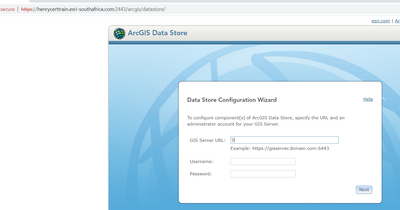

You can check you datastore cert  by opening the url https://localhost:2443/arcgis/datastore then looking at the cert info.

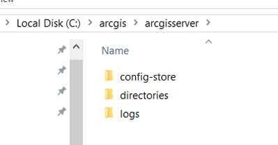

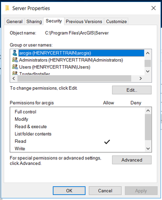

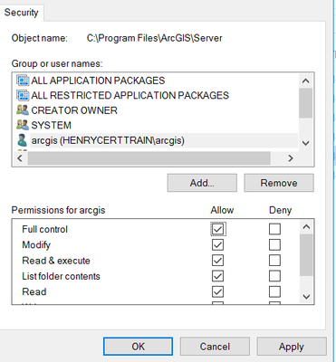

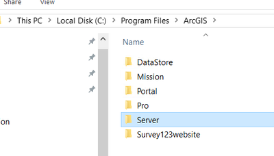

Then can you go to services and look which service account is running your ArcGIS server then reapply the security rights on the folder structure at c:\program files\arcgis\server and the location of you configstore c:\arcgisserver or d:\arcgisserver...
Service account
config-store
Program Files
right click and open server properties then security and your service account make sure it has full control on these folders, there is a new Windows policy that changes the service account to read only.
after you have applied this you can check if your ArcGIS server is functioning.
Then there might be a partial file that has been created during your failed publishing go to  C:\arcgis\arcgisserver\config-store\services\Hosted and see if you can see anything also your rest and services will not work if this is the case

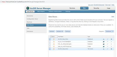

You can also try the following go to server manager and unregister the datastore then re-register it on https://dns:2443/arcgis/datastore
you only have to unregister relational NB did you make the backups
using the https://dns:6443 admin url

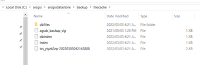

to create the backups run
"C:\Program Files\ArcGIS\DataStore\tools\backupdatastore.bat" --store relational
and
"C:\Program Files\ArcGIS\DataStore\tools\backupdatastore.bat" --store tileCache
please make sure that  they did actual make a backup in the backup location
