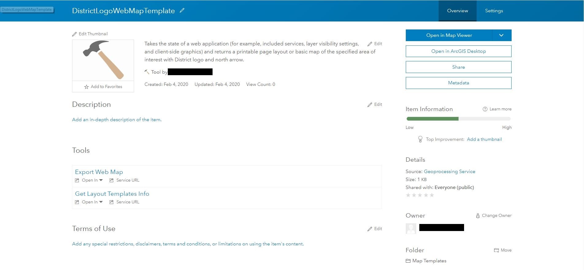

Screen capture of the created tool
What steps am I missing?
