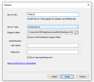

Is it possible to connect to the GIS Server through ArcGIS Desktop to publish services?
In Portal/ArcGIS Pro we sign in using Enterprise Login but I do not see this option in Desktop.

Thanks! So I can sign into the Portal via ArcMap but my only options when I go to File > Share as > Service are to publish hosted services. The data is coming from SDE so we'd like to published referenced services instead. Can this be done?

tigerwoulds
So simple. I never even thought to use the username/password directly. I was so used to the 'Enterprise Login' button to automatically pass my credentials through. Thanks!
