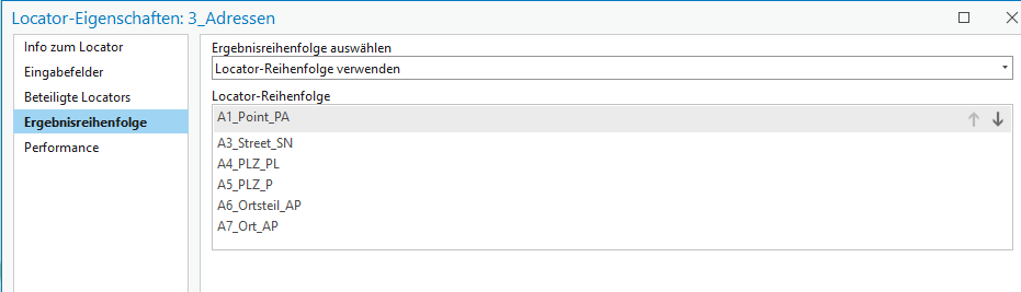

Currently we are building a composite locator: Streets, addresses, cities, cities with post codes as an example.
the composite locator works just fine in arcgis pro 3.1.2:

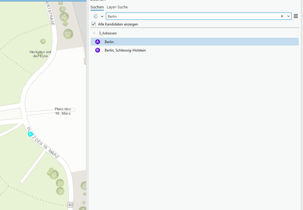

Looking for Berlin gives me 2 results with the Main city Berlin with a rank 1 marked as "A" in AGS Pro:
The results are sometimes errativ in ArcGIS pro but most often it is just the two results. So far: when I am publishing this service as a gecoode service to my ArcGIS Server the suggest endpoint finds all strange addresses with a "Berlin" in it's name but struggles to use the rank field to provide me with the first city name instead. Yet, the order might be of interest:
So, from this perspective I seem to be also more interested in Point_PA (real Adresses) compared to Ort_PA (cities with only city names)
Is the suggest endpoint build to respect the rank of the results?
