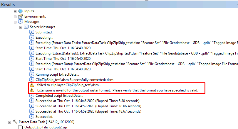

When executing the tool from ArcGIS Server, I have noticed that when I select smaller area, it works just fine, but when I draw larger polygon in order to clip larger area from the source raster there is a problem, the output is only few KB and if I try to open it in ArcMap, nothing is displayed. This happens when tiff is chosen as an output format. I checked the GP results window and I think the message is misleading (Invalid extension), which is definitely not the case since the exact same tool with the exact same settings works perfectly fine when I select smaller area AND tiff is supported by default in the Extract Data Model from ESRI.

I am having the same problem with tiffs.  I'm trying to use the published service I have created in a map application, and it generates a tiff, but when I bring it into a map, nothing shows up.
