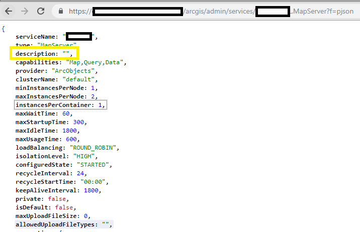

Hello,
how can I change map service "Service Description" with Python? I would like to avoind changing the Service Description in arcgis/manager manually or republishing the map services.
Changing the "description" properties with Python via the admin route didn't take any effect what so ever. I assume these properties are not supposed to be linked to each other?
Thanks for any help.
Monika
