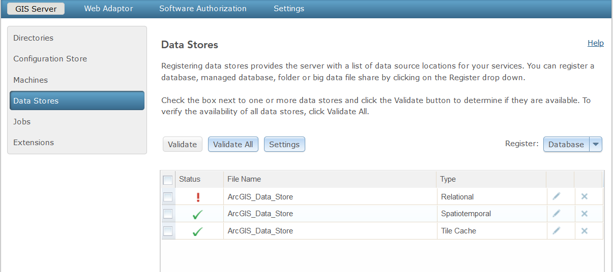

kindly help me:
after renew license arcgis enterprise, i can not validate arcgis_data_store "relational".
Server log:
-   Message:  The connection property set was missing a required property or the property value was unrecognized. No ArcGIS server license found. Contact your geodatabase administrator to update license.
-   Source: DataValidator.GPServer
image attach:@

Hi Hau,
Have we gone ahead and updated the license for the ArcGIS Data Store? This can be done if we use the "updatelicense" ArcGIS Data Store utility. This Documentation goes over the command line utility and how to use it properly.
Best of Luck!
-Sam

HauTran_Phuoc
Hi Sam,
exactly, thanks so much!
