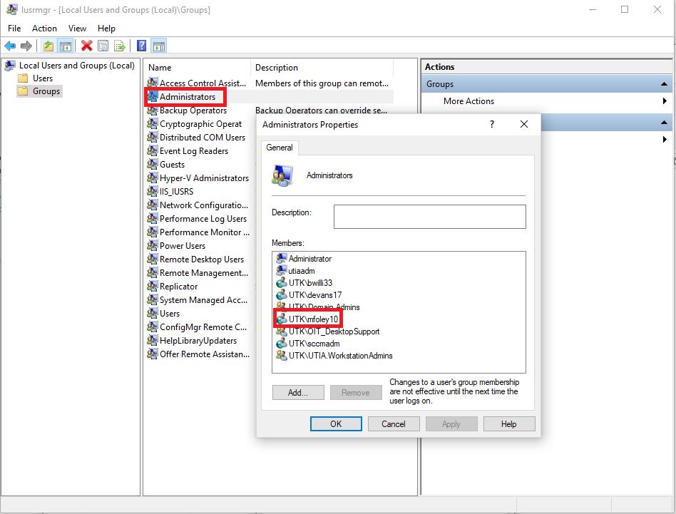

After running lusrmgr.msc on my publishing machine, I can see my domain user in the Administrator group.

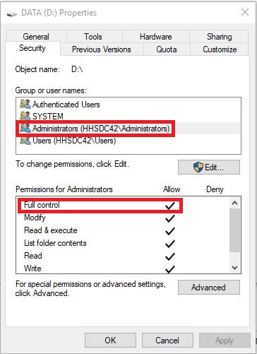

I am trying to access folders in the 😧 drive, so I check that the administrator group has full control there. Note I have also checked that the administrator group also has full control over the exact folder I want to register; it does.

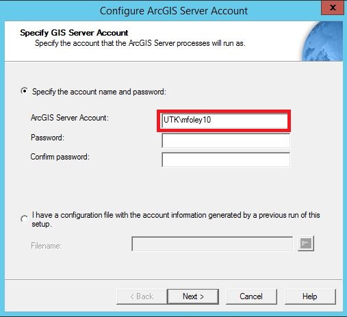

The ArcGIS Server Account has been configured with the same domain. I am logged into the server machine as this user also:

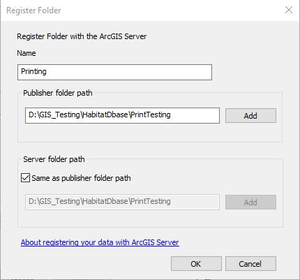

This is how I'm trying to register the folder from Desktop:
I do not have a 😧 drive on the server machine, could that be the issue? I only have a C: drive. Do I need to use a UNC path (if so, do you have an example of what it would be? I've never used one before)?

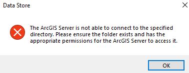

Error I get:

Since the 😧 drive is on another machine from where ArcGIS Server is installed you need to specify a UNC path as you mentioned.  It would be something like this:
\\gis1\GIS_Testing\HabitatDbase\PrintTesting
gis1 is the name of the server.  You will want to make sure the GIS_Testing folder is shared on the other server.  If you right-click on the folder > Properties > Sharing tab it should state whether it's shared or not, and if it is, it will provide the UNC path.

I think you can use the D-drive location for the where you are publishing from as you had it in the first screen shot, but then use the unc path for the Server folder path as you have it for the Server folder path in your second screen shot.

Also, can you double-check the ArcGIS Server service is using the UTK\mfoley10 account by going to Start > Services.  It should be listed under the Log On As column:
