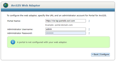

Hi people,

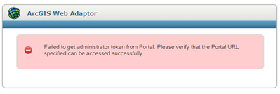

I am trying to configure the web adaptor for my Enterprise portal, specify the URL and an administrator account for Portal for ArcGIS, but I always receive the error: "Failed to get administrator token from Portal. Please verify that the Portal URL specified can be accessed successfully."

In the first box, remove "https://" and see if that works.  Starting at 10.7, the requirement changed to be just the hostname of the machine (see example under the first box).

Thank you very much for your answer. It worked, but I am not entirely sure if that was the only solution, because in the meantime, I also reset the port bindings and I configured my firewall to accept other ports. But in the end it worked, so thanks again!

I'm stuck at this point also. I've tried several variations on what I entered in the first box, including:
However, I continue to get the error: "
Failed to get administrator token from the server. Please verify that the specified server can be successfully accessed."
ReeseFacendini
Esri Alum
On the machine where the web adaptor is installed, can you get to the https://MyNewArcGISServer.domain.org:6443/arcgis/manager Url in a browser tab? If that page doesn't load in a regular tab, then the web adaptor won't be able to register.
ahargreaves_FW
@ReeseFacendini thanks for the direction. I could NOT reach  https://MyNewArcGISServer.domain.org:6443/arcgis/manager  from my web server. As a couple other threads that are similar to this one indicate the fix, for me, was to open ports 6443 and 7443 within the firewall.
