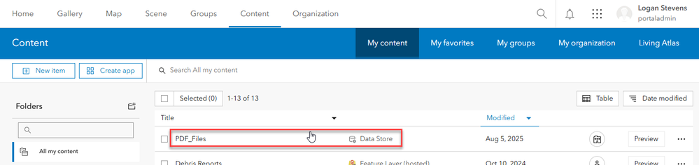

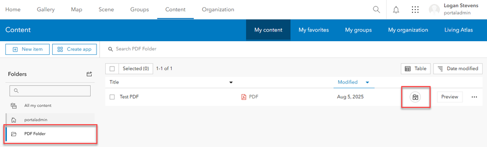

Logan_Stevens
Hello! It seems like you're looking to register a folder with ArcGIS Enterprise through Content > New Item > Data Store. When creating a new folder connection in ArcGIS Enterprise, make sure that ArcGIS Server has the right permissions to access it before proceeding with registration. After that, you can publish the data in the folder using ArcGIS Pro. This process is relevant if you intend to publish the data in the folder as a registered service in ArcGIS Enterprise.
However, I think you might be interested in creating a folder connection within the enterprise portal to view and link to PDFs available in your organization. Unfortunately, this isn't possible in the same way I described above (at least to my knowledge.)
Have you thought about uploading your PDFs directly to the enterprise portal? You could create a dedicated folder within your content in the organization and upload your PDFs there. After that, you can share these PDFs with your organization and link to the items themselves. Since the PDFs would live in your enterprise portal, your organization members shouldn't have to sign in again to view them. It's not a perfect solution, but that's the first thing that came to mind when I saw your question. I hope this helps!

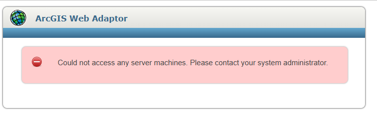

In IIS, (IIS > Sites > Default Web Site > portal) I added a Virtual Directory called “Vault” to "portal".   This Virtual Directory pointed to a folder with PDF files on my E:\ drive but I got the web adaptor error shown in image below.  Then I repointed the Virtual Directory to a new PDF folder under the “content” folder of the portal configuration (this could be problematic when the next Enterprise update is done).  But it didn’t work either.  For testing purposes, Anonymous Authentication = Enabled, Windows Authentication = disabled.
In both of these instances, I then went to https://domain.bla/portal/vault/filename.pdf.  That’s when I got the error message.
Can you identify what it is I’m doing wrong?  Thanks.
MuneerMajid
Hi @PLadd - You shouldnt create the virtual directory inside your web adaptor or touch/change anything with it.
You would want to create this virtual directory under your website root such that your pdf folder directory https://domain.bla/vault/fielname.pdf
