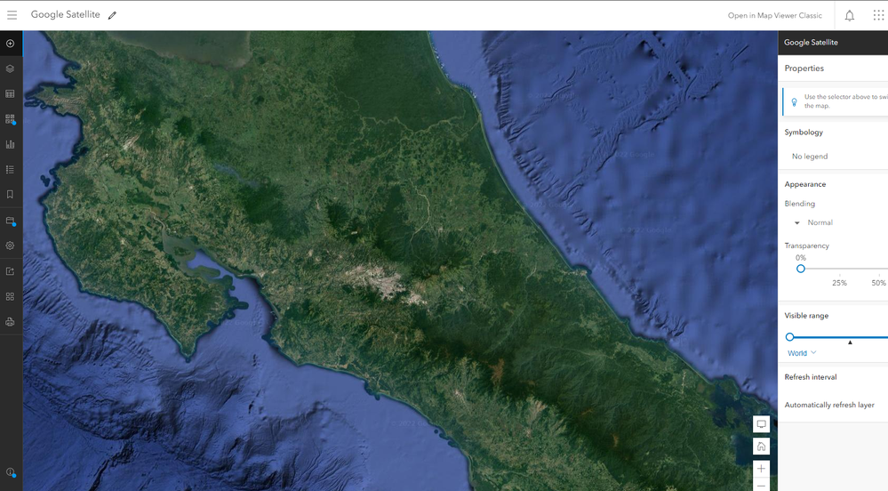

DanaYoung
Thank you for this, I have seen this information before and all works great in WAB. But do you happen to know if there is another link for the "Google Satellite"? That is the only one that does not work in the new map viewer..... Thank you!
lvargas
Hello Dana,
You are right, I did the test in the new map viewer and it doesn't seem to work (in the old map viewer, it does). I have searched and yes there is a different url that can be used.
Google Satellite
https://mt1.google.com/vt/lyrs=s&x={col}&y={row}&z={level}
I have tried that one and it works fine.
Regards.
DanaYoung
Thank you so much!
