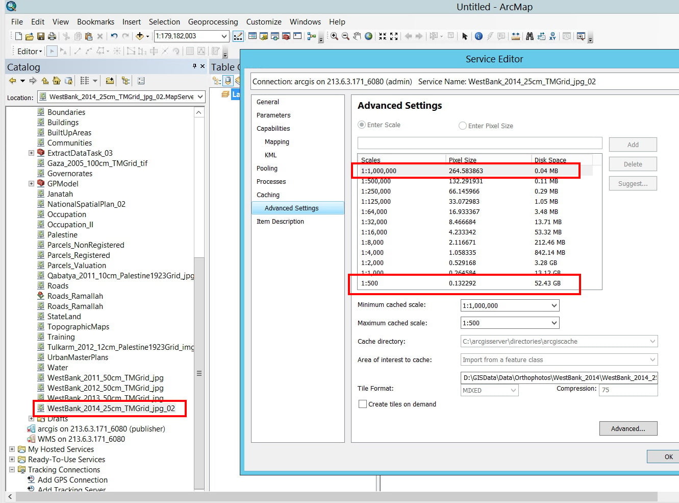

I wanted to cache an already cached service at new scale but I couldn’t figure out how to do this task.
For example, I wanted to cache the service below at 1:2,000,000.
How this can be implemented?

First, you have to stop service. Then you can open map service properties and add new scale on advanced cache settings.
After updating cache settings, you can start and update caches for that scale.

Many thanks hsarslan for the help,
I got a help from colleague to add a new scale to the cached service without having to stop the service.
