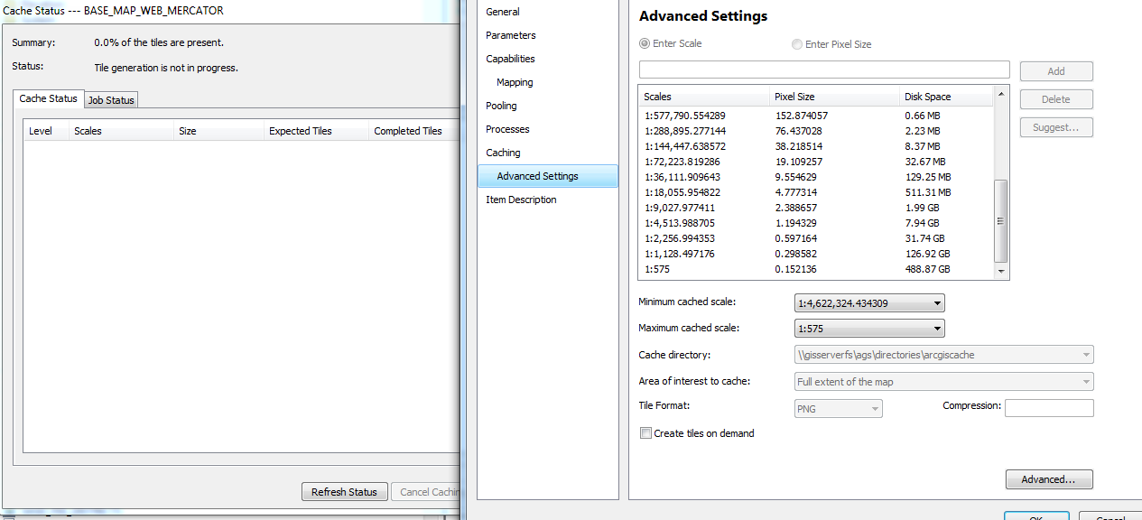

Our cached base map has been through several software releases. Thinking back it has been through all of them starting at 10.1, 10.1 SP and beyond. We are now at 10.2.2 and for some reason the cache status no longer appears and not even the levels are not even listed. Anyone know how to restore this functionality? We really do not want to rebuild the cache and know that will be the first instruction from ESRI support.
It seems the metadata is corrupt or something but it still works producting images and can be updated using Manage Cache Tiles.
We have deleted the Status.gdb and rebuilt cache status, rebooted server with no avail. Below is what we see... nothing! Any other ideas?
