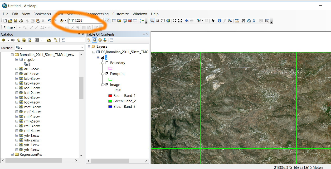

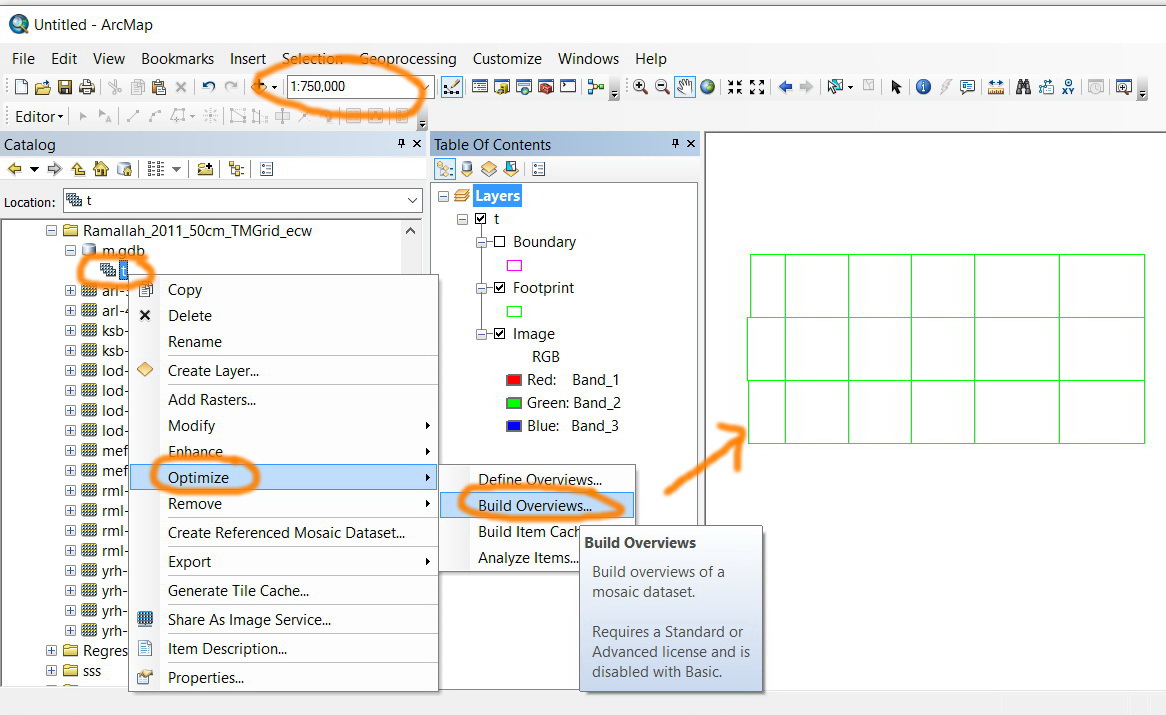

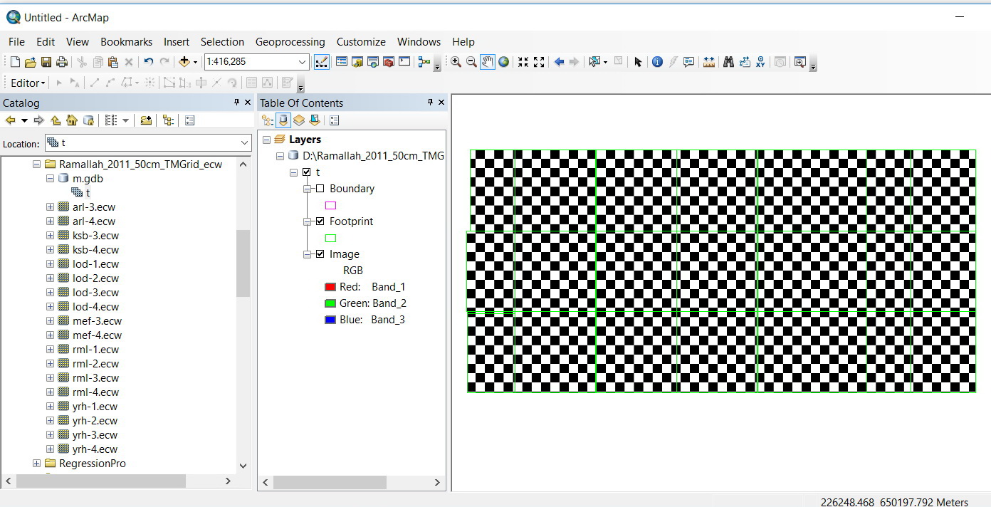

Applying “build overviews” for a mosaic generates black\while tiles,
For example, in the screenshots below, in order to let the mosaic appear in all scales, the “build overviews” is applied. However, this generates black\while tiles.
How this might be resolved?

I went through the links you have already provided but it appears that they don’t provide root solution for the issue. I got no tools that that can fix it.
