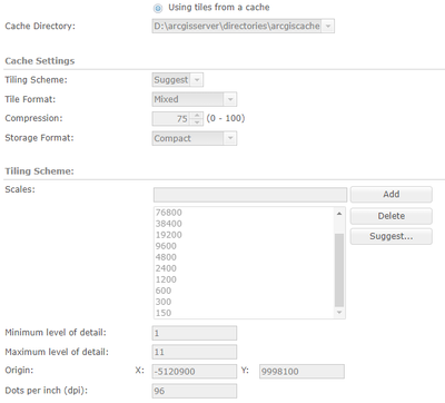

I have a similar thing I need to do once a year. I actually just publish mine as a map service. At one time in the past I specified cache settings (scales, etc) and now when I publish my once-a-year aerial, I use the previous year's cache settings to pre-load into the new map service.
