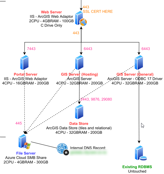

Thanks. I think we are clear on the disk sizes and install location. I want to take this opportunity to extend the topic a little to the overall architecture.
Here is the full picture from which I cut in my original post. However, I have simplified it by removing the file server (also my intention was to use it as a configuration store) out of the equation, and want to focus on the main tiers.
This is a multi-machine with 2 x ArcGIS Server deployment, non-HA. We chose to put everything behind the firewall with a separate web adaptor tier for below reasons:
1, simplicity on the architecture design
2, less firewall configuration from IT or infrasture service provider, easier to scale horizontally
3, able to use webgisdr tool (I think if to put web adaptor in DMZ, there is an issue running the webgisdr tool?)
However, we hope to disable the REST API web interface and Service Admin API if accessed externally. Is this achievable with the above setup?
Also, if removing the dedicated web adaptor tier and installing the 3 x web adaptor on the Portal Server as you would normally do, I can see the benefit of resource-saving. Is there any other benefit from doing that?
