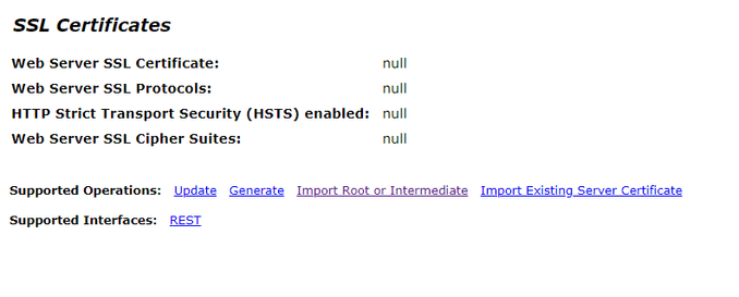

We have noticed something. In the HA portal, the standby machine that is complaining with "You are not authorized to use this resource." when admin is trying to log in, has lost the SSL Certificates configuration! When we joined this machine to the portal site, we had set correctly the root and server certificate. Screenshot 2020-11-25 153921.png
If we try to update this configuration, then we receive this
As a workaround, we have tried to:
  1. stop the standby machine,
  2. restart the primary,
  3. start the standby again
Sometimes this pattern works, sometimes not...
Another point is that the following link: https://standbymachine.domain.com:7443/arcgis/sharing/rest/generateToken returns a 404 error message. Everything works fine for the primary machine.
Any ideas will be very helpful!
